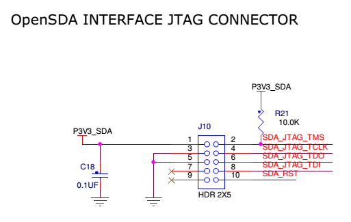

     i am using FRDMk64FN1M0VLL12 controller. and i am using KDS2.0 and KDk1.1.0. i want to dump code into controller
using P&E multilink universal instead of OPENSDA. how to interface controller and JTAG pins. if i want to change any jumper setting..?
anybody give clear idea about this, its useful to me.

Hello Sudhakar,
The FRDM-K64F has a header for the JTAG interface. In the FRDM-K64F schematics you can see the connections. You don't need to change any jumper settings.
Earl Orlando.

hi,
     thanks for your reply.after connecting board what are steps i want to follow,please give some documentation with image because i am NEW. previously i used OPENSDA. i dnt want to spoil my board.i am using KDS 2.0 IDE and KSDK 1.1.0 MQX. and also when i program through P&E from which addree it will start writing on internal flash is depend on linker file?

EarlOrlando
Senior Contributor II
In KDS,
1. Go to the Debug Configurations... Menu
2. Double click over the PEMicro option.
3. Be sure that in the Main tab in the C/C++ Application: option is selected the path to the .elf file.
4. In the Debugger tab click over the Select Device button.
5. Select your MCU, in this case Freescale > K6x > K64FN1M0M12. Once it is selected click over the Debug button.
Earl.
