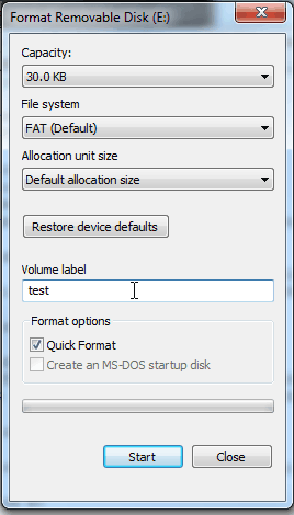

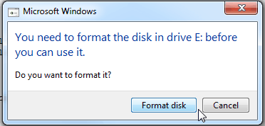

Actually the application is always opening up the ram disk and checking if it is formatted or not.  I just choose to ignore the MQX application and use the PC to load the ram disk with file as shown below.  So at this point in time both the MQX application and PC want to format the ram disk.  I choose to have the PC app do it for this example (read observations below).

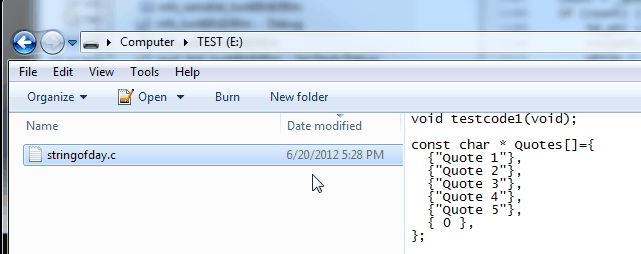

When the application first runs, I plug the TWR USB cable to PC, PC will want to format it, I format it, then copy (drag-n-drop) a file to the TWR ram disk.

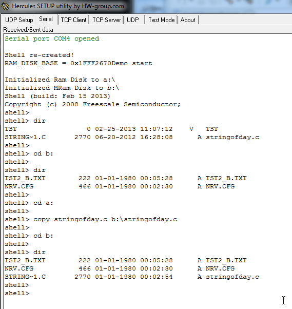

Using the serial concole I can copy/move the file from ram disk to MRAM.
Note the "a:" is the ram disk and "b:" is the MRAM disk.

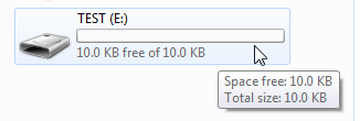

When formatting the ram disk with Win7 64-bit machine, it initially sees the drive as 30KBytes but after the format only 10KBytes is present.  I'm guessing extra overhead of Windows formatting???
When I format using the MQX application I get the expected 25KBytes.  If Windows looks at this ram disk it does see all 25KBytes.  So clearly we have a difference in formatting the FAT32 from MQX to Windows.
