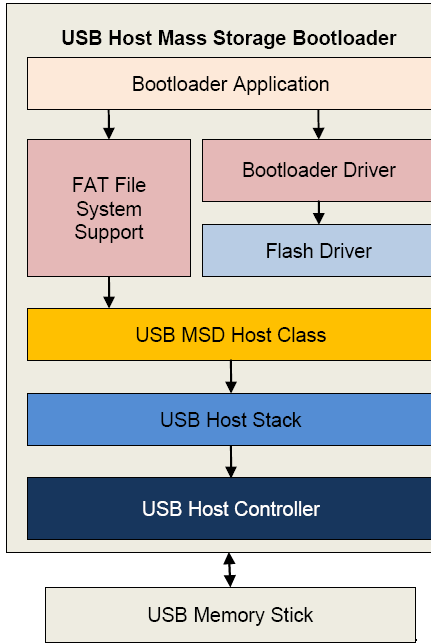

Hi Robin:
We have a bootloader based on USB stack, it uses the FAT file system-supporting module to read an image file and then uses the bootloader driver to program the image file to the flash memory of the device. So it is possible to access the image file in USB stick.
For details, please refer to the document
http://cache.freescale.com/files/microcontrollers/doc/app_note/AN4368.pdf
You also can download the associated source code AN4368 from Freescale website.  The demo is based on K60, not K64
For SD card support, we do not have an existing demo, I think you need to add sd card support into this bootloader package.
