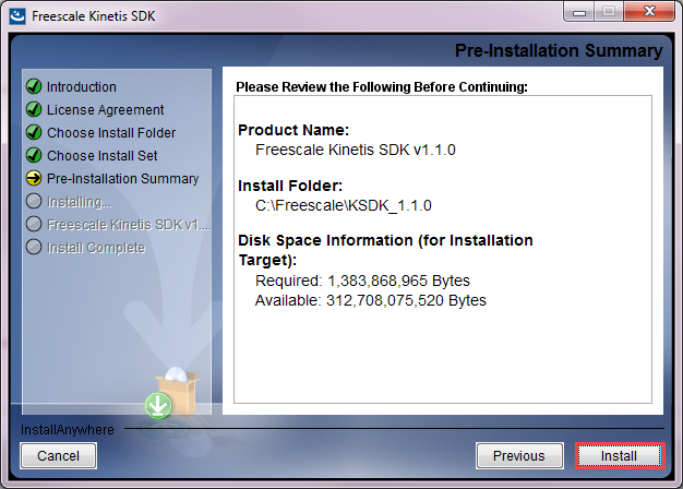

Hello Abhishek,
for installing KDS - Kinetis Design Studio Integrated Environment (IDE)
        and according to your platform please download the executable file.
For additional information you can see documentation for KDS, be aware you install 2.0
The procedure is very easy, firstly you must accept the conditions,
and that´s it. The workspace would probably be at C:\Users\<your profile>\workspace.kds and KDS folder could be here C:\Freescale\KDS_2.0.0
for installation KSDK, please visit Freescale MQX™ RTOS for Kinetis SDK|Freescale and Download it according to your platform
and install it.
You can go back after installation and modified it, don´t worry.
I can also recommend you Getting Started with Freescale MQX RTOS for Kinetis SDK which is located after this installation at C:\Freescale\KSDK_1.1.0\rtos\mqx\doc

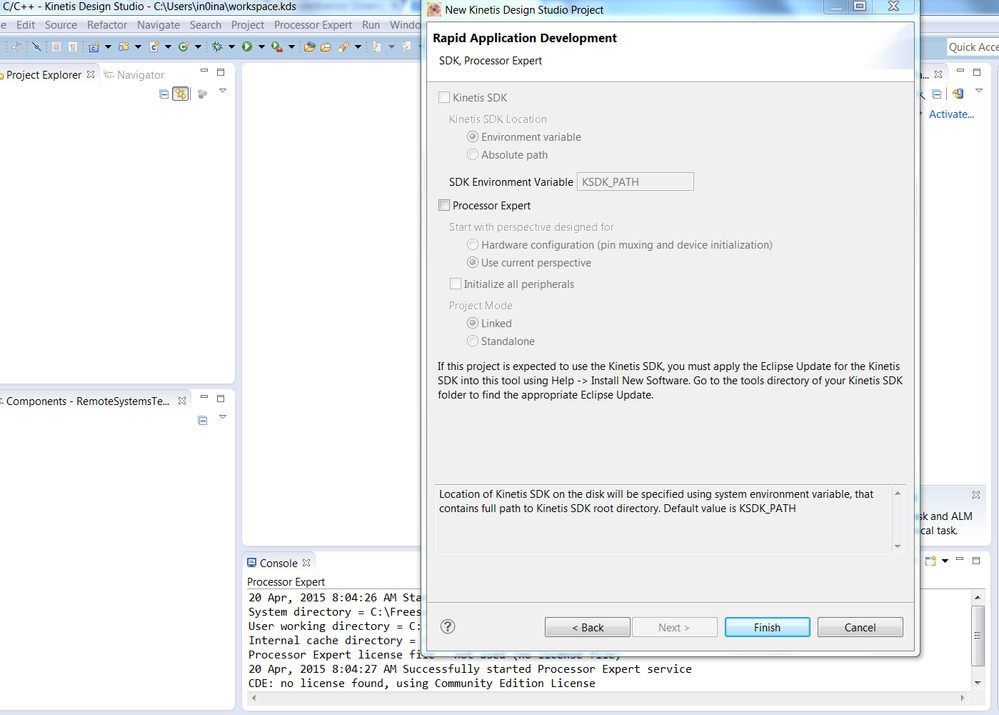

Hello Iva,
     Thanks for the replay, we did the installation of KDS IDE, KSDK and MQX RTOS (Downloaded and Installed) as in the steps mentioned above. As also did the "Help - New Software Install - Kinetis Eclipse KSDK Update(.zip file) Link:C:\Freescale\KSDK_1.1.0\tools\eclipse_update\KSDK_1.1.0_Eclipse_Update.zip). But still we don't have the option to select the "Kinetis SDK" as shown in the image below.

Hi Abhishek,
Three things to try:
1) Review this post Re: I can not create a new KDS 2.0 project for MK22FN1M0xxx12 with Kinetis SDK support.
2) Did you do update of KDS using Help->Install New Software... and select Freescale KDS Update Site - http://freescale.com/lgfiles/updates/Eclipse/KDS ...then Select All and follow wizard steps ?
3) Un-installed the KSDK plug-in and re-install?  Help->About Kinetis Design Studio->Installation Details... then select the KSDK 1.1.0 Eclipse Update and click Uninstall...

abhishekinamdar
Hello David,
We tried all the three methods mentioned by you, still not able to get access to KSDK for TWR-K60 board as shown below.
But if we select other board say FRDM-K22 then we have the option to check KSDK as shown min below images.
Please help regarding the software, we are planning to use two boards for our RTOS programming project:
  1. TWR-K60D100M: Kinetis K60 100 MHz MCU.
  2. FRDM-KL25Z.
