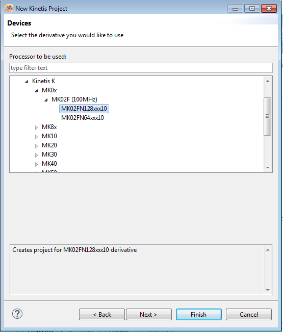

I wish to generate a new project configuration for KSDK v1.3.0 with MQX but I can’t find how to do that. Three months ago, we generated a project for the FRDM-K22F on KSDK 1.3.0, using MQX as the RTOS, and we implemented a lot of code based on those parameters. Now we’ve switched to our final board, which has as its core the MK02FN128VLH10, and we wish to use the code that we previously implemented for the K22F for our board with the K02F. I seem to be able to generate a configuration for the MK02FN128VLH10 for KSDK v2.x, but not a configuration for the MK02F for KSDK v1.3.0 with MQX. How can I do that? Thanks.

Hi David:
Please refer to the below document to create a MQX RTOS project for KSDK
How To: Create an MQX RTOS for KSDK project with Processor Expert in Kinetis Design Studio IDE

Thanks, Daniel. That document is exactly what I was looking for.
