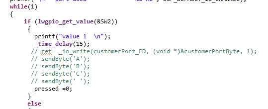

Hi Team,
following is my startup code for K21 tower board. .
I am using codewarrior 10.6 and MQX4.2
I configured "ttya" serial port for RS232.
I have a problem. In "void button_task(uint32_t)" when I use _time_delay(any number  e:g 100, 1000 ms) then i am not able to send data on "ttya" serial port.
If i remove _time_delay(x) function from that task, then i am able to send data on "ttya" serial port.
Please note that in void led_task(uint32_t) task, _time_delay(x) is making correct delay.
Am I making any mistake in using _time_delay(x) function or configuring serial port?

I have slightly modified button_task. now if i give delay of 15 sec it is sending good characters but if i give delay of 105 ms, it is not giving me good characters.
void button_task
      uint32_t initial_data
    volatile int i=0, j=0, k=0;
    unsigned char customerPortByte = 's';
    unsigned char customerPortByte1 = 't';
    unsigned char ret = 0;
    customerPort_FD = fopen(customerPortName, 0x00);
    printf("value init task %d.\n", customerPort_FD);
    ret =   ioctl(customerPort_FD,IO_IOCTL_SERIAL_SET_BAUD,&customerPortBaudrate);
    printf("init value %x \n", ret);
    /* Initialize GPIO  */
    if (!lwgpio_init(&SW2, LWGPIO_PORT_C | LWGPIO_PIN7, LWGPIO_DIR_INPUT, LWGPIO_VALUE_NOCHANGE))
       printf("Initialising switch 2 failed.\n");
       _task_block();
    else
        printf("SW2 initiated.\n");
    lwgpio_set_functionality(&SW2, LWGPIO_MUX_C7_GPIO);
    printf("\n - port used            = %s Hz", BSP_DEFAULT_IO_CHANNEL);
    while(1)
        if (lwgpio_get_value(&SW2))
           printf("value 1  \n");
           _time_delay(15);
           sendByte('A');
           sendByte('B');
           sendByte('C');
         else
           printf("value 2  \n");
           _time_delay(105);
           sendByte('D');
           sendByte('E');
           sendByte('F');
2,106 Views

Hi Sudhanshu,
I think the issue was mainly the stack size of PWM task.
Summary of my Debug Process:
I played around with different configurations initially and added _time_delay() to button_task and was getting unhandled exception in the pwm_task when a _time_delay() was used.  If I didn't use _time_delay() in button_task then I did not have unhandled exception.
I increased all tasks stacks *2 and code started to work.  I used the MQX TAD to see the stack size.  Then I reduced the tasks stack to around 80% and all seems stable.
I've attached my main.c for the pe_demo using the C:\Freescale\Freescale_MQX_4_2\demo\pe_demo\build\cw10gcc\pe_demo_twrk21f120m project.
Hardware Setup:
TWR-K21F120M+TWR-SER
I removed J13 jumper from the default pins 1-2 of TWR-K21F120M card.
I removed J19 jumper from default pins 1-2 of the TWR-SER card.
I jumpered the UART0_TX/PTA14 from J13 pin 1 of TWR-K21F120M card to the TWR-SER card J19 pin 1 to allow me to output to UART0/ttya.
David

in the button task, inside while(1), inside if condition, if you comment everything printing on uart0(only in if condition part not in else condition part), and then execute the program, then when you press "SW2", data in else case will not go correctly to uart0..
