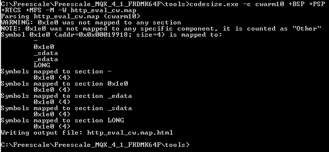

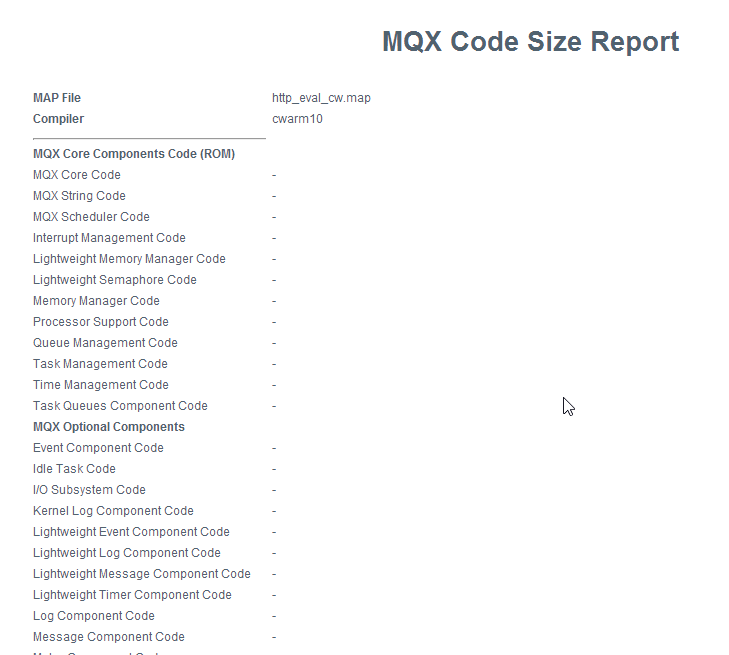

I'm trying to use the codesize tool available in the MQX 4.1 tools folder. However the html output gives me no information, as in the following image:
All itens are as above, with an '-' symbol. This is the command I'm using and the stdout output:
Do you have any idea on why this could be happening? I've tried searching another threads here without success.
Thank you!

It should work.
However: Are you sure that you used CW compiler? GCC is currently not supported by this tool.
CW compiler/linker typically generate *.xMap file instead of *.map file.

I can't test if it will work as a change of toolchain now will be hard, but you're right: I'm using GCC and haven't realized it is not supported!
Hope I can find something similar that works with gcc soon!
