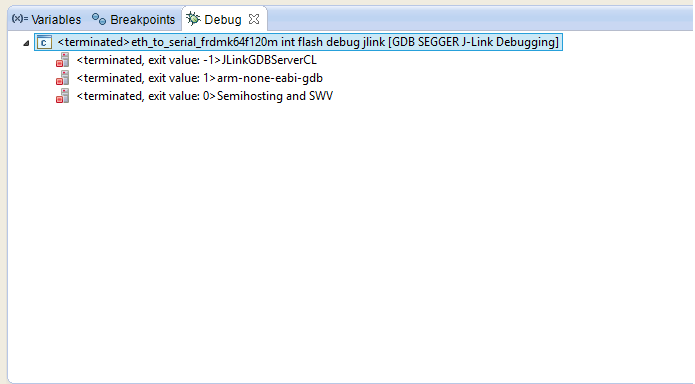

kevincarcel
Hello Luis and Alice
I've got buil a example  MQX project thanks to your explanations also I've tried to include in a project with PEx, the component MQX and MQX task after of take out all errors and compile without problems I can't debug because appear this error in console:

How can i solve this errors? This is a method valid method to create a MQX project?
Thanks for your help

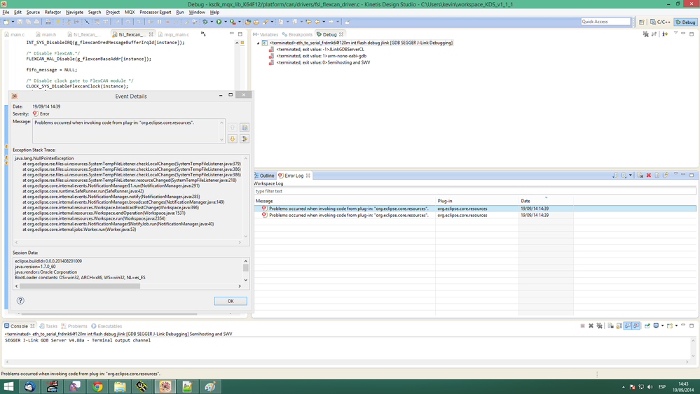

kevincarcel
I am unable to debug a sample project eth_to_serial. I've gotten buil without errors but not generated .elf. In comand windows appear this error:
arm-none-eabi-gcc: error: ..\..\..\..\..\..\..\..\..\lib\ksdk_mqx_lib\kds\K64F12\debug\ksdk_mqx_lib.a: No such file or directory
How I can generate the file .elf installation? Does anyone have an example that i can debug in the FRDMK64F?

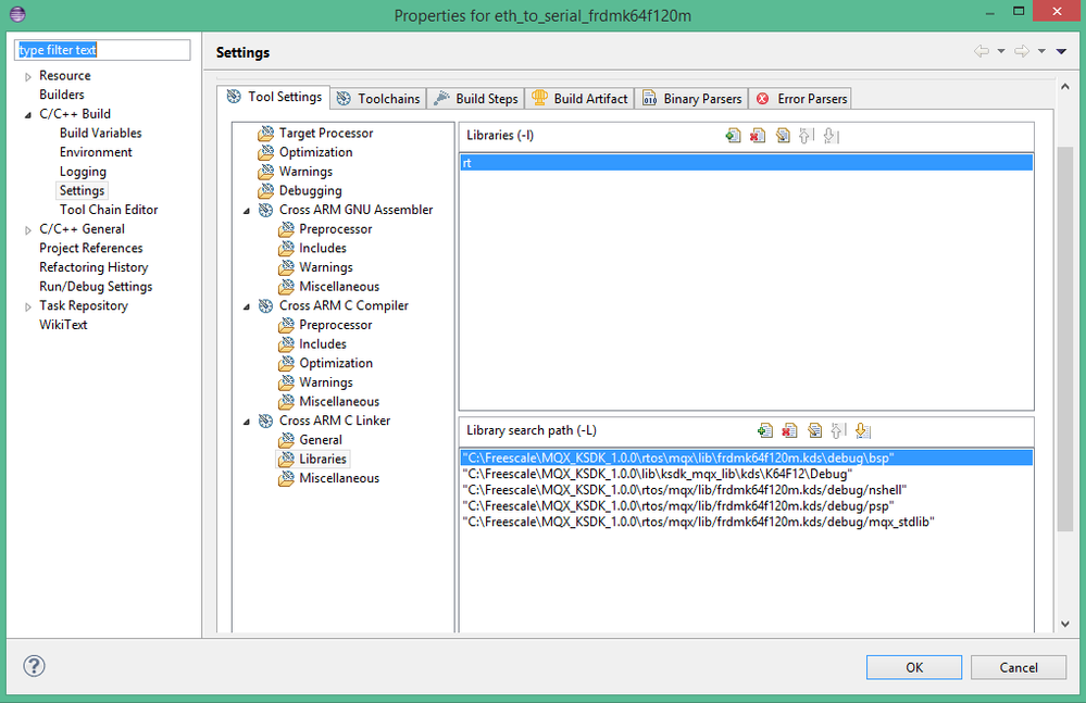

kevincarcel
Hello Luis
Thanks for help me, your respond has been useful. Now I tried to change the original project, and appear again this error:
08:49:00 **** Incremental Build of configuration Int Flash Debug for project eth_to_serial_frdmk64f120m ****
Info: Internal Builder is used for build
"C:\\Users\\kevin\\workspace" KDS v1.1.0/eth_to_serial_frdmk64f120m/makedir.bat C:/Users/kevin/workspace KDS v1.1.0/eth_to_serial_frdmk64f120m/int flash debug
C:\Users\kevin\workspace KDS v1.1.0\eth_to_serial_frdmk64f120m\Int Flash Debug>IF NOT EXIST "C:/Users/kevin/workspace" mkdir "C:/Users/kevin/workspace"
arm-none-eabi-gcc -mcpu=cortex-m4 -mthumb -mfloat-abi=hard -mfpu=fpv4-sp-d16 -O0 -fmessage-length=0 -fsigned-char -ffunction-sections -fdata-sections -Wall -Wno-missing-braces -g3 -gdwarf-2 -gstrict-dwarf -gstrict-dwarf -gstrict-dwarf -T "C:/Users/kevin/workspace KDS v1.1.0/eth_to_serial_frdmk64f120m/../../../../../../../rtos/mqx/lib/frdmk64f120m.kds/debug/bsp/K64FN1Mxxx12_flash.ld" -nostartfiles -nodefaultlibs -Xlinker --gc-sections -Wl,-Map,eth_to_serial_frdmk64f120m.map -Xlinker --cref -Xlinker -z -Xlinker muldefs -Xlinker -static -o eth_to_serial_frdmk64f120m.elf -Xlinker --start-group "Sources\\main.o" "Sources\\TCP_IO.o" "Sources\\FlexCAN_IO.o" "C:\\lib\\ksdk_mqx_lib\\kds\\K64F12\\debug\\ksdk_mqx_lib.a" "C:\\lib\\frdmk64f120m.kds\\debug\\rtcs\\rtcs.a" "C:\\rtos\\mqx\\lib\\frdmk64f120m.kds\\debug\\nshell\\nshell.a" "C:\\rtos\\mqx\\lib\\frdmk64f120m.kds\\debug\\bsp\\bsp.a" "C:\\rtos\\mqx\\lib\\frdmk64f120m.kds\\debug\\psp\\psp.a" "C:\\rtos\\mqx\\lib\\frdmk64f120m.kds\\debug\\mqx_stdlib\\mqx_stdlib.a" "C:\\Freescale\\KDS_1.1.0\\toolchain\\lib\\gcc\\arm-none-eabi\\4.8.0\\m4\\fp\\v4-sp-d16\\libgcc.a" "C:\\Freescale\\KDS_1.1.0\\toolchain\\arm-none-eabi\\lib\\m4\\fp\\v4-sp-d16\\libc.a" "C:\\Freescale\\KDS_1.1.0\\toolchain\\arm-none-eabi\\lib\\m4\\fp\\v4-sp-d16\\libsupc++.a"
"C:\\Freescale\\KDS_1.1.0\\toolchain\\arm-none-eabi\\lib\\m4\\fp\\v4-sp-d16\\libm.a" -Xlinker --end-group
arm-none-eabi-gcc: error: C:\lib\ksdk_mqx_lib\kds\K64F12\debug\ksdk_mqx_lib.a: No such file or directory
arm-none-eabi-gcc: error: C:\lib\frdmk64f120m.kds\debug\rtcs\rtcs.a: No such file or directory
arm-none-eabi-gcc: error: C:\rtos\mqx\lib\frdmk64f120m.kds\debug\nshell\nshell.a: No such file or directory
arm-none-eabi-gcc: error: C:\rtos\mqx\lib\frdmk64f120m.kds\debug\bsp\bsp.a: No such file or directory
arm-none-eabi-gcc: error: C:\rtos\mqx\lib\frdmk64f120m.kds\debug\psp\psp.a: No such file or directory
arm-none-eabi-gcc: error: C:\rtos\mqx\lib\frdmk64f120m.kds\debug\mqx_stdlib\mqx_stdlib.a: No such file or directory
08:49:00 Build Finished (took 203ms)
I have compile this libraries. Can you help me? thanks.

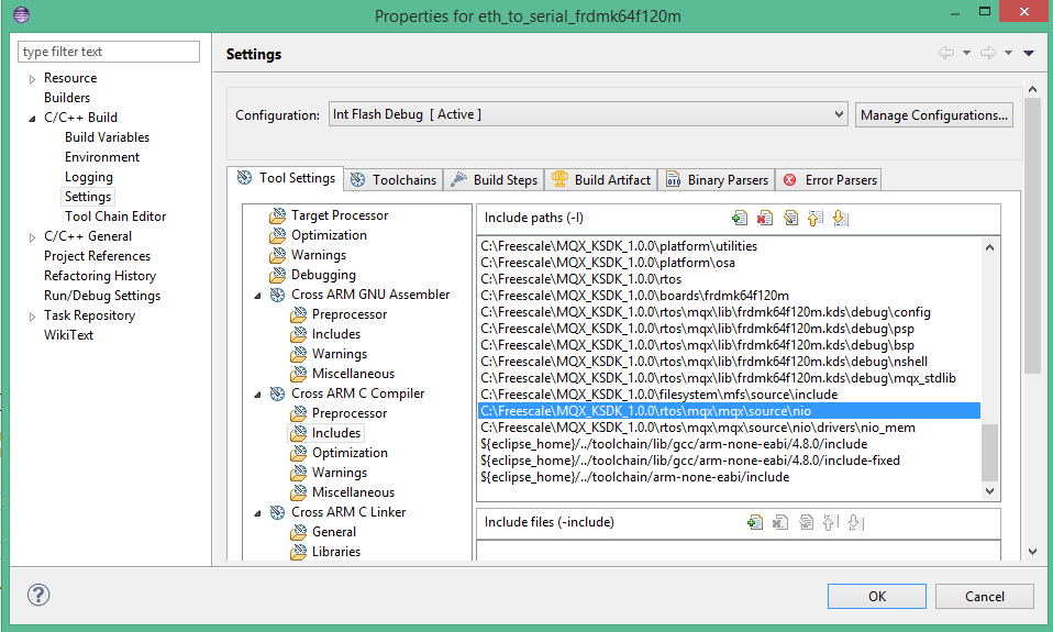

kevincarcel
Hello Luis
Yes I build the example project and the new project without errors. I have changed much of the project and have included cunimucacion CAN.

Your problem is in the path of the libraries:
C:\rtos\mqx\lib\frdmk64f120m.kds\debug\xxxxx
Review the projects paths in your new project.
Luis
8,861件の閲覧回数
kevincarcel
The paths of the libraries are same as in the example project and I check that exist.
Which  be the problem?
thanks Luis
8,861件の閲覧回数
LuisCasado
Hello kevin,
And the linker settings?
Luis
8,861件の閲覧回数
kevincarcel
the linker settings is same.
thanks
8,861件の閲覧回数
LuisCasado
Post your project. I don't know what the problema is.
Luis
8,860件の閲覧回数
kevincarcel

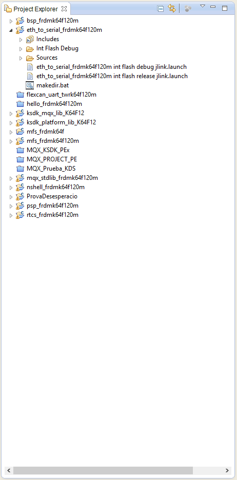

LuisCasado
Hi Kevin,
I see all the paths modified to absolute location. So, what is your goal? do you want to generate a MQX-KSDK project position independent? And work outside of the MQX-KSDK source tree?
Luis
8,860件の閲覧回数
kevincarcel
Hello Luis
My intention was to create the project in my workspace, for not modify the sample project.
thanks

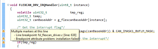

kevincarcel
hello Luis
When I add a breakpoint appear the warning:
in de debug windows appar:
the error log is:
Finaly, in the console windows appear:
I hope that this pictures help you
thanks Luis
8,860件の閲覧回数
LuisCasado
It looks like KDS related. I see that issue is in one of the files you added.
Erich Styger , Any idea about this error?
