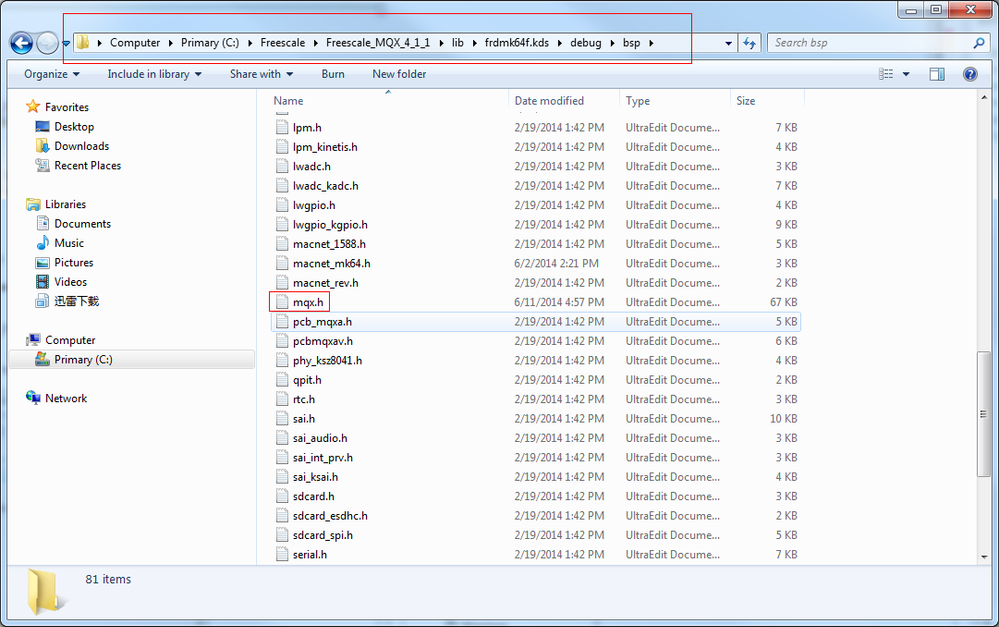

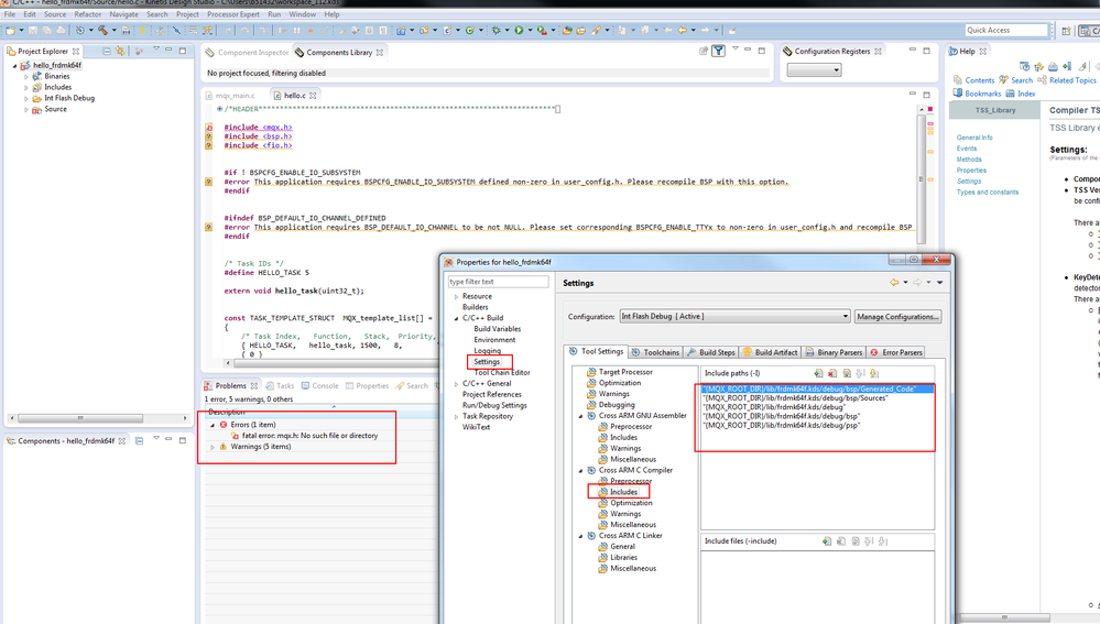

Hello Luis,
I create MQX project on kds  refer to you said ,while when build ,the compiler can't find the .h files , any other places need to be configured ?
Thank you !
Alice
708 次查看
Hello Luis and kevin,et all
I'm so sorry that I just know MQX 4.1.1 released, thank you Luis.
Alice
