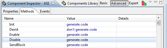

I've found the MQX Lite driver model is different than MQX, MQX Lite drivers are generated by Processor Expert with a pre-determined functionality and are not intended to be messed with.
My application requires me to Disable / Enable the a UART (SCI / AS) port every period of time, and I cannot find that functionality in the P.E. Driver, how can I go about obtaining this functionality.

Hello Carlos,
if you are using Serial_LDD driver you can use Enable and Disable methods. Both are not generated by default so you have to switch to Advanced or Expert mode and set Value to "generate code"
