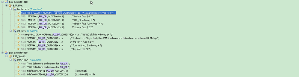

I am not sure which version of MQX that you are using, from the current MQX 4.1, I just found the BSP for MCF54418, and only two places modify that register, so I am suspecting if you just modified one place and the other still kept the old settings. Please kindly refer to the following for details.

We are using MQX 4.0.1 and we have the same settings as in the snap posted by you.
However, on reading the value of PLL_DR, we get OUTDIV4 = 3.
No matter at how many places we change the value of OUTDIV4, we always get 3.
Even in BSP, the value of OUTDIV4 is set to 7, but during debugging it shows 3.

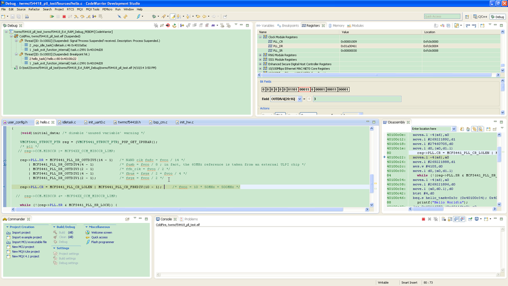

As I just have TWR-MCF54418 on hand , so I just did simple test based that board, actually I found PLL_DR can be modified as any value as you mentioned, you know , RM says "The PLL_DR[OUTDIVn] fields can be changed during normal operation or when the device is in limp mode." so I tried that in both modes, DIV4 can be changed to 3 in any test, but I am not sure how you change PLL_DR, but I'd like to recommend changing PLL_DR under limp mode. Would you please help to clarify? Please kindly refer to the following for details.
Limp mode test:
Normal mode test:
