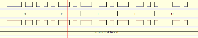

Hi, I'm trying to get rs232 to work on our custom hardware which uses the K60F120M cpu. For uart 4 we have TX = PTE24 and RX = PTE25. To get this to work I made the following change in our BSP in init_gpio.c:
case 4:
            pctl = (PORT_MemMapPtr)PORTE_BASE_PTR;
            if (flags & IO_PERIPHERAL_PIN_MUX_ENABLE)
                pctl->PCR[24] = 0 | PORT_PCR_MUX(3) | PORT_PCR_DSE_MASK; //TX
                pctl->PCR[25] = 0 | PORT_PCR_MUX(3) | PORT_PCR_DSE_MASK; //RX
            if (flags & IO_PERIPHERAL_PIN_MUX_DISABLE)
                pctl->PCR[24] = 0;
                pctl->PCR[25] = 0;
            if (flags & IO_PERIPHERAL_CLOCK_ENABLE)
                /* start SGI clock */
                sim->SCGC1 |= SIM_SCGC1_UART4_MASK;
            if (flags & IO_PERIPHERAL_CLOCK_DISABLE)
                /* stop SGI clock */
                sim->SCGC1 &= (~ SIM_SCGC1_UART4_MASK);
            break;
I've then made a small example to test if it works:
  #define RS485_CHANNEL "ittye:"
   MQX_FILE_PTR rs485_dev = NULL;
   char  data_buffer[6] = {0};
   data_buffer[0] = 'H';
   data_buffer[1] = 'E';
   data_buffer[2] = 'L';
   data_buffer[3] = 'L';
   data_buffer[4] = 'O';
   rs485_dev  = fopen( RS485_CHANNEL, NULL );
   uint32_t baud = 19200;
   ioctl(rs485_dev, IO_IOCTL_SERIAL_SET_BAUD, &baud);
  write( rs485_dev, data_buffer, strlen(data_buffer) );
  fflush( rs485_dev );
What happens when I run this code is that what I send on the TX is also what I get on RX (but inverted) even though it isn't connected to anything else than the logic analyzer I use to meassure. So it seems that somehow, everything I send out I recieve an inverted copy of. How can I get rid of this behaviour? Did I do anything wrong when changing init_gpio.c?
Just to clarify, this is the result from my logic analyzer (where the top signal is tx and the bottom rx):

Hi Daniel, I managed to find the problem. I had to add the following line:
OSC1_CR = 0x00;
to disable XTAL1 which was the default option for PTE25
在原帖中查看解决方案

Hi Jesper:
Please check the UARTx_S2 register, there is one bit to control the Receive data Inversion.

Hi Daniel, the RXINV bit is already set to 0. Also they way I understand is that the RXINV bit only inverts the data that is coming in from an external source. But as I said in my first post, there should be no data coming in on the rx pin. I also checked the LOOPS bit in the UARTx_C1 register but it is 0 as well.

Please also check the TXINV bit in UARTx_C3
