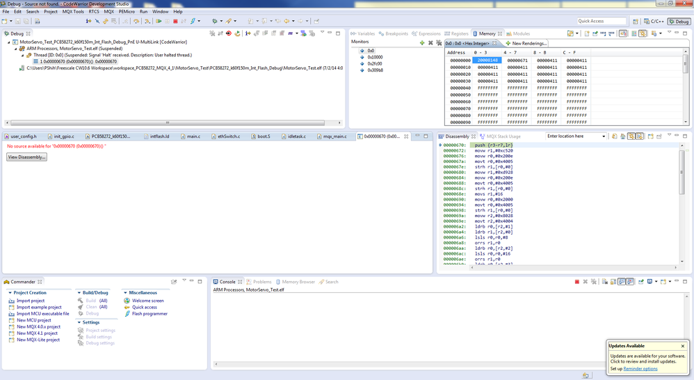

Hi:
I have developed my application based on the K60 MCU (MK60FN1M0VLQ15) with MQX 4.1 on a custom board. All BSP, libraries, application have been developed well and all peripherals on a custom board are running OK. I am ready to modify linker file to offset the code location in order to work with bootloader. I modified the "vectorrom (RX): ORIGIN = 0x00010000", "cfmprotrom (R): ORIGIN = 0x00010400" and "rom (RX): ORIGIN = 0x00010420" and compiled successfully. However, after I download the image through debugger. The debugger doesn't point to the right start address in RAM, and cannot run with debugger. I have verified the code are loaded at 0x10000 right address.

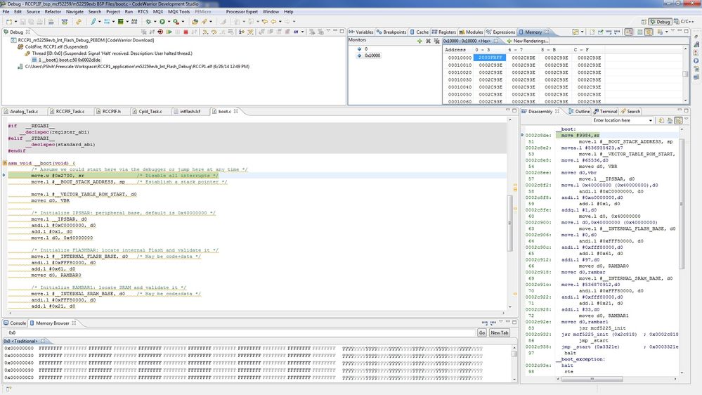

I worked with a similar project by using MCF52259 with MQX 3.8. The debugger was able to download my mcf52259 application at right ROM address and ready to run at the right RAM address. Please refer to the enclosed picture for detail.
I do have "#define MQX_ROM_VECTORS 0" set in the BSP "user_config.h". I don't know what I missed. Please advise me if you have any recommendation. Thanks!
Peter

Hi Peter,
This behavior is because the program counter will always look, coming from the reset, for the address 0x00000000 but does not find anything there because now you modified the linker adding an offset to the vector table of the application; and the debugger is not able to say to the program counter where are now the vectors of the application.
I recommend to you to develop and flash your bootloader in order to do not leave empty that address. Anyway this is not a problem with the application it is just a problem with the debugger. You can make the test to leave the vector table of your application in the address 0x00000000 and just modify the linker to move the rom section, where your code is, and now when you debug this program again you will not find problems.
I hope this information can help you.

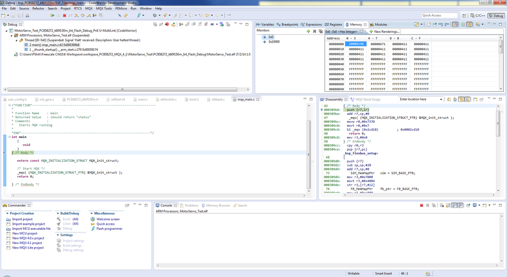

When I entering debug mode in the application development environment, the debugger runs to main() as you have seen in the above picture. Once I reset the debugger, it starts from 0x670, which is the entry point of bootloader: _main(). If you "Resume", eventually the debugger runs to the application code area through bootloader. I think the bootloader code residue at 0x0 is just like a jump board to the application code.

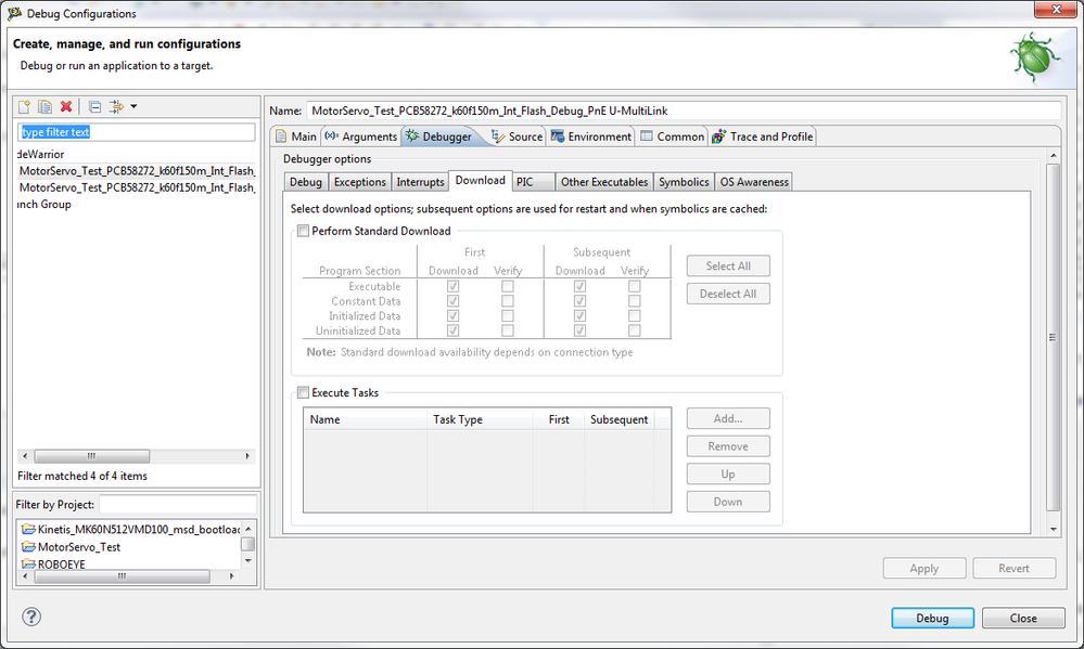

I have found and downloaded a useful "Serial Bootloader" from AN2295 (HC08/S08 Developer's Serial Bootloader) updated for rev. 9.2 - CF V1 (alpha) support added. With minimum modification, I was able to make this work on my target board. Then I flashed both bootloader and application with offset starting address into my target board by "Flush file to Target" through CW10.6. The system works fine.
Back to application development, I also was able to enter debug mode without downloading image. Now I can debug my application with bootloader code residue at 0x0. You can refer to "Microcontroller_FAQ_Guide.pdf, 7.4 Flash Programmer" for detail.
The only drawback is I cannot make change and download it to my target. I have to either make debugger to erase and program application section only, or I have to combine both bootloader and application at post-process. You can refer to Re: K60 s19 file generation for detail. Again, thank you very much.
