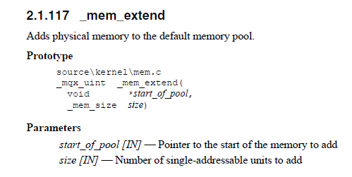

danielchen
For how to use DDR in MQX, you need to call _mem_extend to add physical memory to the default memory pool.
Please read MQX_Reference_Manul
Please also read https://community.nxp.com/message/409116?commentID=409116#comment-409116  for how to use _mem_extend.
Danile
