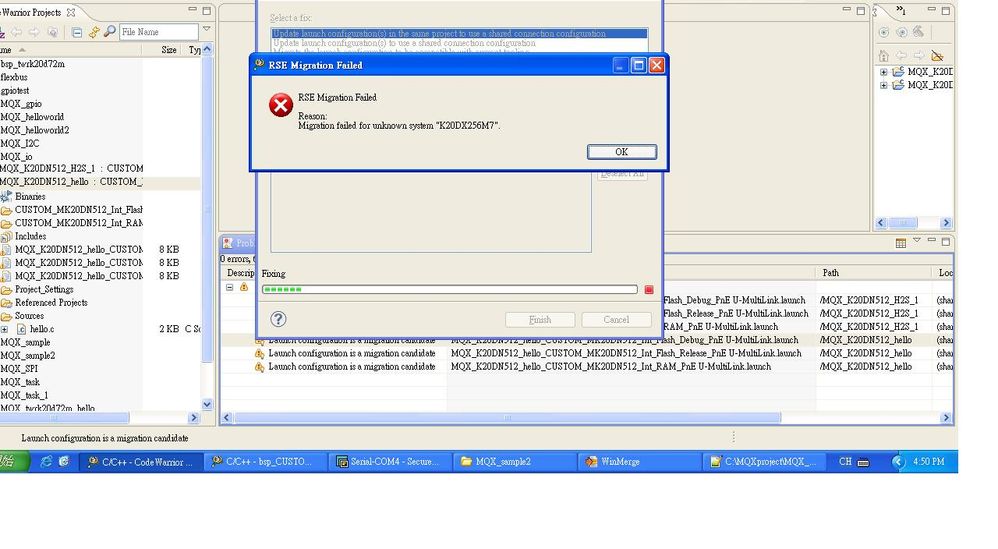

miniwang
I have succeeded in create new BSP for my custom board.
but there is a waring message when I new a project use custom BSP.
"Launch configuration is a migration candidate"
I try to use "Quick Fix", but it's fail. (please refer the attached image)
the MCU of custom board is MK20DN512, and the custom BSP is cloned copy from "twrk20d72m".
I have tried to replace the "K20DX256M7" to "K20DN512V10" or "K20DN512V", of course, it doesn't work.
how can I fix this problem? or what system name should I use?
thank you in advance.
Mini
8,697 Views
Martin_
I suspect the "c:\Freescale\CW MCU v10.2\MCU\lib\wizard_data\mqx\3.8\mqx_TWRK20D72M.xml" is not cloned properly to the new board. I think you should change only the board name and board ID (not the processor type) in the xml file. Try using your clone on the original TWRK20D72 board and let it work (try loading some simple application to the TWRK20D72 board and debug).
Once this basic clone is working, you can start making changes to the processor type in debugger configuration and connect the debugger to your custom board.
8,697 Views
miniwang
Hi Martin,
Thanks for your suggestion. I have checked my xml file. It's followed the document you provide, only change the board name and board ID. And I have tried to use the original one to build a project, but it seems have the same issue. so that I think it might be something wrong with the original one(twrk20d72m). (Does anyone have the same problem?)
I'm trying to install CW10.2 and MQX3.8.1 on other pure OS again. hope can solve the problem.
thanks for your help.
