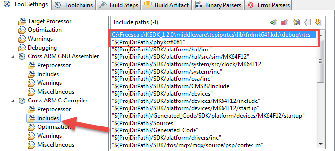

for the file rtcs.h, it is located at C:\Freescale\KSDK_1.2.0\middleware\tcpip\rtcs\lib\frdmk64f.kds\debug\rtcs
I would suggest you check that folder. And check whether this path is added correctly.
  • Go to menu Project > Properties > C/C++ Build > Settings > Cross ARM C Compiler > Includes and add the following paths:
  • C:\Freescale\KSDK_1.2.0\middleware\tcpip\rtcs\lib\frdmk64f.kds\debug\rtcs

Followings are steps which cleared rtcs.h file not found error.
1. Import->FileSystem-> rtcs from C:\Freescale\KSDK_1.2.0\middleware\tcpip\rtcs\lib\twrk60d100m.kds\debug\rtcs in my current project.
2. In Cross ARM C Compiler->Include , I added ${ProjDirPath}/rtcs instead of C:\Freescale\KSDK_1.2.0\middleware\tcpip\rtcs\lib\twrk60d100m.kds\debug\rtcs
3. In Cross ARM C++ Linker->Miscellaneous, I include ${ProjDirPath}/rtcs/lib_rtcs.a instead of C:\Freescale\KSDK_1.2.0\middleware\tcpip\rtcs\lib\twrk60d100m.kds\debug\rtcs\lib_rtcs.a
4. Remaining setting are same as per https://community.nxp.com/docs/DOC-106170
And this solved my problem.
I simply import rtcs folder inside my project and give the library path of project(${ProjDirPath}/rtcs and  ${ProjDirPath}/rtcs/lib_rtcs.a are path showing that rtcs.h and lib_rtcs.a is now inside my project ).
The Same setting is working for MFS library. Instead of rtcs folder, I Include mfs folder and done the settings as above in terms of mfs.

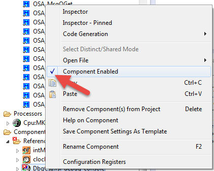

Please check the below post to remove "Error in the inherited component settings (MQX)"
How To: Create an MQX RTOS for KSDK project with Processor Expert in Kinetis Design Studio IDE
I also copied here
By the way, if you select MQX Standard in the MQX_KSDK Configuration parameters, the remaining steps will look like this.  This is because the MQX Standard configuration uses the more full featured fsl_uart component for serial communication, while the MQX Lite configuration uses the simpler DbgCs debug console component.
Select MQX Standard.
Click on the DbgCs1 component.
Disable it by un-checking the Component Enabled checkbox.

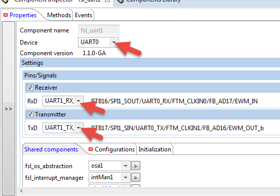

Now configure the fsl_uart component (used in place of DbgCs1).
Select the UART to use and the pins.
On the Configurations tab, select a baud rate.  Note:  You may have to tweak the clock configurations to work with your selected baud rate or vice versa (see above).
Now generate the code as in the steps above and write your tasks!
With MQX Standard, you can now access the tcp/ip stack, file system, posix io subsystem, and other advanced features included with MQX RTOS.
