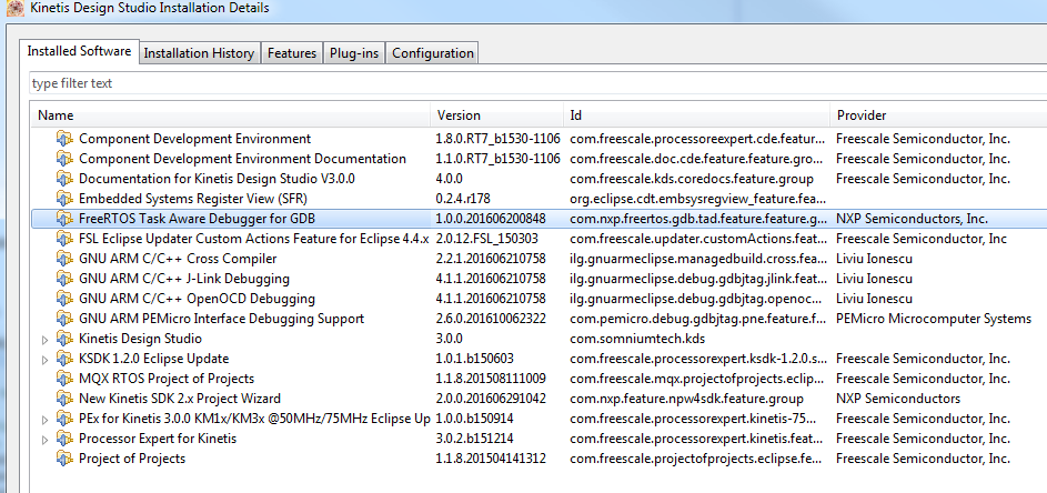

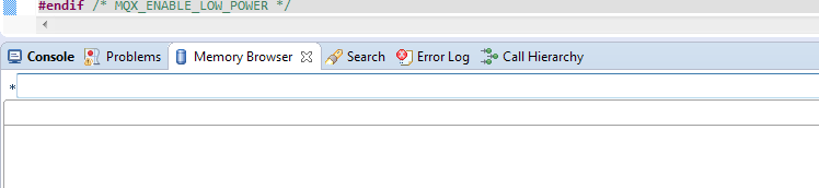

I'm working on a board with a K64 processor, KDS_3.0.0 KSDK_1.2.0 tools, MQX.  At one point in the project the Task List and Stack Usage became unavailable. I have gone back previous versions of the project where I know it was working, but no longer works, so it's not related to  project settings or stack size as I have seen in other posts. The error log shows:
and the MQX Task List tab shows:
Task aware debugger is installed:
Any ideas?

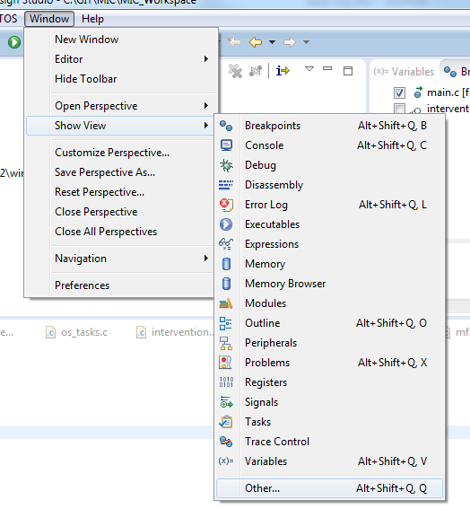

Update:
I removed the MQX Task List tab from the window
and re-added it back and the task list and it was restored.
Selected Other then selected MQX Task List from the MQX folder.

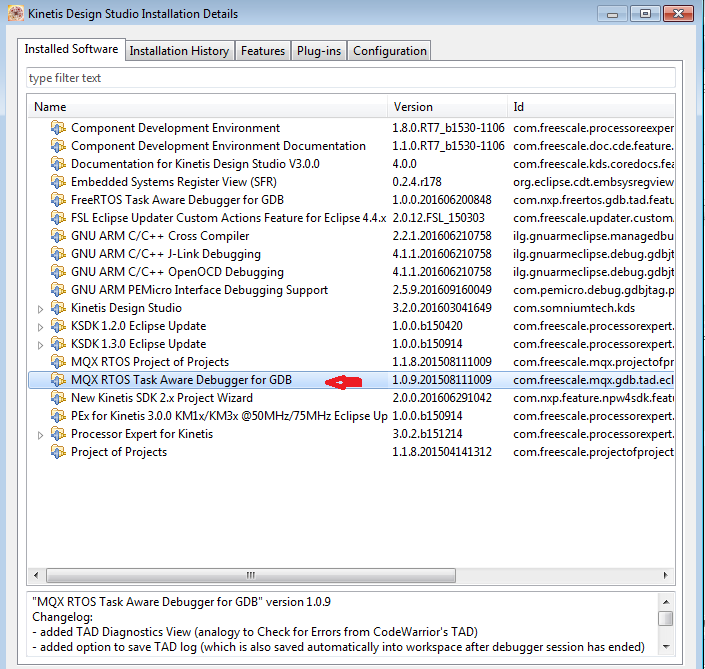

Hi George Joseph
I tried the MQX task list with KDS 3.2, and it can work.
It seems that MQX RTOS Task Aware Debugger for GDB is missing in you KDS installation.
