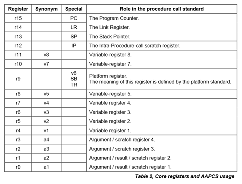

 Now, put breakpoint to this my_kernel_isr and see the registers read by prvGetRegistersFromStack(). Typically at most interest would by "lr" and "pc". For example, "lr" would have an address of an instruction that a return from a function call would return to.

Notes about Cortex M4 registers:
MQX sets active stack pointer to PSP in boot.s
The core automatically switches the active stack pointer to MSP in handler mode and switches back to PSP with exception return
