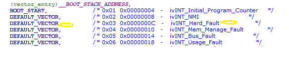

For Hard Fault, we can hook our exception handler into the vector table. we will find vector table in the vector.c source file in the BSP library. By default, isr is configured to DEFAULT_VECTOR, which is the _int_kernel_isr() function of the MQX dispatcher. We cam put our own function, like void my_kernel_isr (void), to vector table offset 0x0c.

Hook our own kernel isr into the vector table
In file vectors.c,   the default ISR for Hard_Fault is DEFAULT_VECTOR
Now we modified it to my_kernel_isr, so when hard fault happens, my_kernel_isr will be executed.

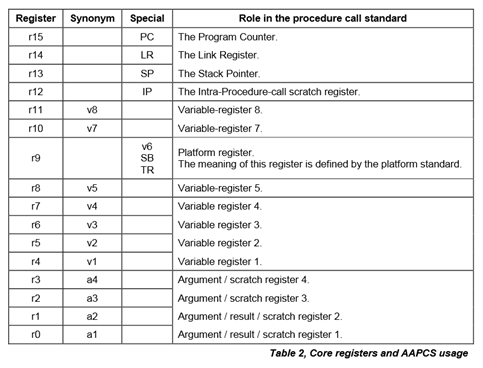

Notes about Cortex M4 registers:
MQX sets active stack pointer to PSP in boot.s
The core automatically switches the active stack pointer to MSP in handler mode and switches back to PSP with exception return
