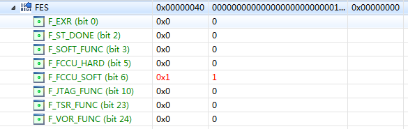

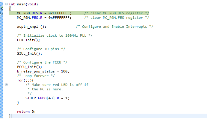

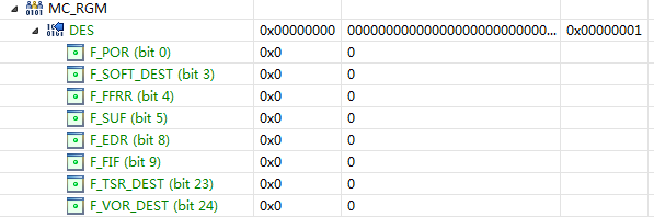

yanronglu
HI,David:
I've already reset the function, but ram is still zero.
The following is the state of the reset.
The project is an additional variable in the FCCU in the example program.
    Can you help me see what went wrong?
Thanks.
