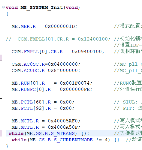

The microcontroller what I used is the SPC560P50L5,but the referance datasheet is base on the MPC5604P.微信截图_20180517112437.png

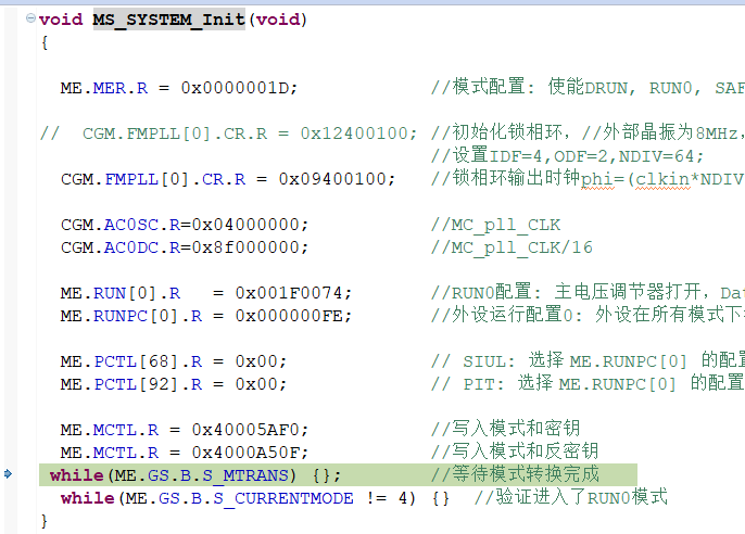

this is how I initialize it .when I use these codes  in MPC5604P which the  external oscillator is 40MHZ,It operation well .but when I use these codes  in SPC560P50L5which the  external oscillator is 12MHZ,it does not work ,the program is stoped at the code "while (ME.GS.B.S_MTRANS){};"when I debug it.

This can be due to CMU unit which checks the crystal frequency as soon as the crystal is enabled in the Mode Entry.
The CMU_0 must be initialized differently from the default value in case of 12 MHz crystal. By defaut it is checked against IRC/1. Try to set CMU_0.CSR[RCDIV] = 3 before you enable XOSC in Mode Entry.

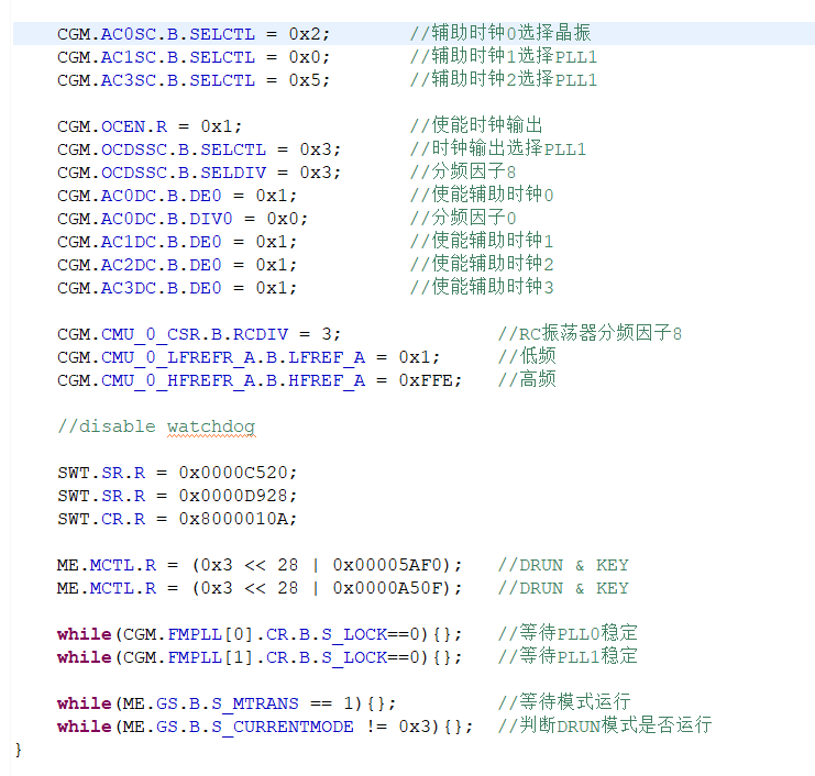

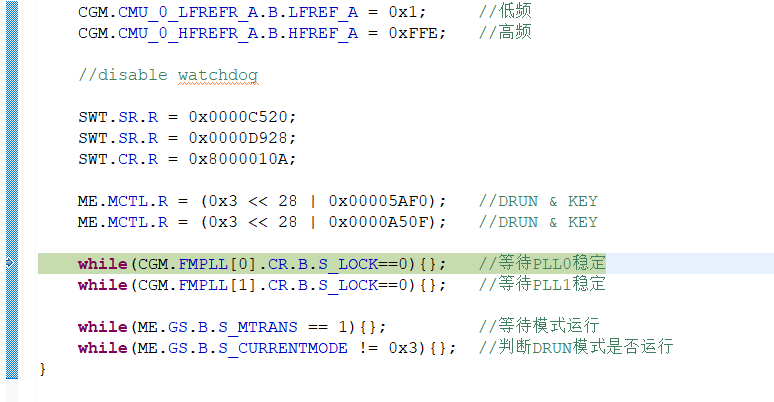

I try these codes,but the result is also does not work!The program stop at the while (CGM.FMLL[0].CR.B.LOCK==0){};3.png  I have set the  CMU_0.CSR[RCDIV] = 3
