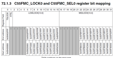

Hi.
The register information of MPC5746C Reference Manual and S32DS is different.
What represents the correct register information? What if I want to unlock the mid block of 0x00FA000?
Is it okay to input the value of 0x00000000U in the mid block like the example program? please answer about my question.
Thank you
1 解答
1,396 次查看
lukaszadrapa
the confusing part here is that S32DS debugger obviously uses different bit ordering. The reference manual marks LSB bit as bit number 31 while S32DS marks LSB bit as 0.
Lukas
