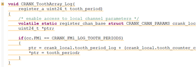

I wonder why these syntax errors are shown when I build my project.
This is EngineControlSet from AN4907SW.
In the problems window, only warnings are shown but I can find these syntax errors on the code side.
Do I need to use a specific compiler from ByteCraft?
What I've done is just install cw10.3 for etpu, import project, and build.

As I know there are 3 different syntaxes for eTPU code development:
- Bytecraft i.e. original functions based on eTPU Function Selector: https://www.nxp.com/webapp/etpu/
- CodeWarrior for eTPU i.r. function based on CW eTPU Function Selector: https://www.nxp.com/webapp/etpu_cw/
- AshWare based on ETEC compiler
If you have source files based on CodeWarrior for eTPU you should be able to used it in CW10.3
