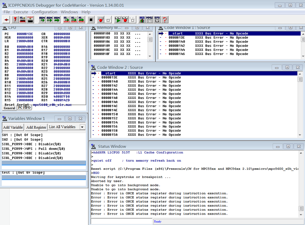

I have encountered some problems in the use of SPC5604BCLQ  144pin .

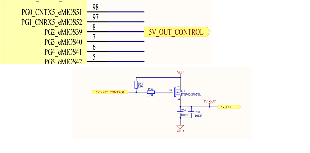

I want to control Enable/Disable 5V out for sensor.
I select PG2 to set GPIO Output to control it.
There will be some error occur when I Enable the  SIU.GPDO[98].B.PDO = 1; as the picture below.
I redo a minimal system circuit, no other input and output pins connected, the program can run normally
Now I want to know if there is a problem with my hardware or software program, how can I solve the problem?

lukaszadrapa
you are not initializing the Mode Entry module correctly, so the SIU module is still freezed and not accessible.
Please take a look at this SW example where you can find how to do that (function FMPLL_init):
Example MPC5604B PinToggleStationery CW210
Lukas
