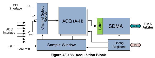

Now i want to make sure whether the SD ADC has completed the sample,but I don't know where is the data  .  If anyone knows how to get the sample data from the SD ADC?  Please help me ~

Is your problem solved? , How to look at the data from the ram, I have the starting address of the ADC, but the data seems wrong

I am not SD ADC expert, but from my point of view, it is not possible to read output data from SD ADC directly. This data are provided to ACQ (A-H) unit, which is also part of Acquisition Block, which executes complex mathematical operation with the data.
If you only need analog to digital conversion without the features of Signal Processing Toolbox, I can recommend you SAR-ADC, which is determined for this purpose.

Hi Martin, very thanks for your reply! However, I don't  know the function of the ACQ(a-h), and i'm  not sure how the data is changed after this unit . And i just know  the sample data  is transfered to  systerm RAM via the SDMA ,so  now i want to read the data from systerm ram , but it's difficult for me .Do you know how to solve this problem?
Besides, I need the ADC works at 10Ms/sec ,so  i can't use the SAR-ADC for its low sample rates but the SD-ADC in AFE.

ACQ is only a small part of the SPE module, which is very complex. I am not able to tell you, how to use it, because it is out of my scope. Unfortunately, I am not able to provide any document or application note how to work with this module.
The only possibility how to get the information about this modules is professional support.
