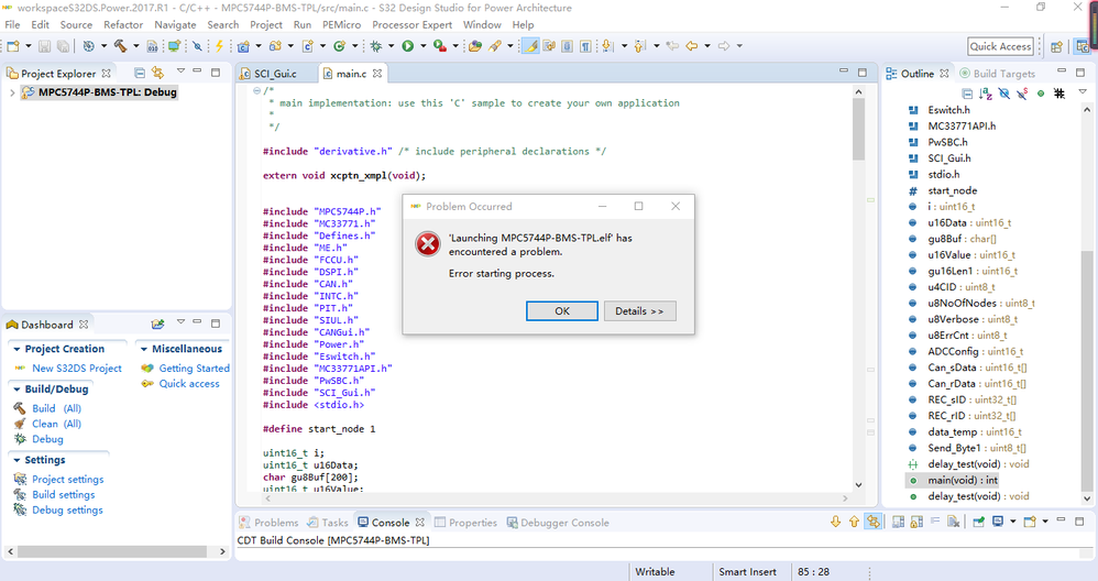

I have installed S32DS IDE and imported a project ,It can be debugged inRAM of MPC5744P,but can not be run.can not run.png

which button did you use for run the program? Only button Debug is implemented, so if you used Run button, this is expected result.

After I built the project, I set the dubug configuration and pressed the debug button,like the illustrating picture,and the project can be debugged and debugged step by step. I pressed "run project.elf", it showed error. If like you said, I want to know how can I download code to flash of MPC5744P and make the code run out of the S32DS IDE and the debugger.

just simply disconnect debug probe or usb cable and reset your microcontroller. Your project will run independently without debugger. Do not forget the code must be loaded in flash memory.
