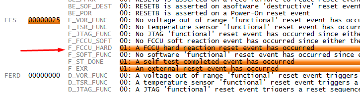

petervlna
I just made test example for NCF[13] with long reset reaction.
I is working as expected.
I can inject fault and then device is reset. After reset I can see that FCCU triggered long reset was triggered.
See pictures below:
Have in mind that this fault injection must be executed without debugger. As debug mode disable RCCU checkers.
I have also attached for reference my test example.
Peter

pederrogo
Hello Peter,
Thanks for your support.
I guess our problem is due to that we configure FCCU using bitwise operations like
FCCU.NCF_E[0].B.NCFE11 = 0x1u;
We have now changed so that 32-bit operations are used like for example
FCCU.NCF_E[0].R = 0x00003800u;
Now, it seems as FCCU is configured as we would like it to, and a long reset is generated for the FCCU faults that are configured with action set to long reset, including RCCU_1.
Peder
