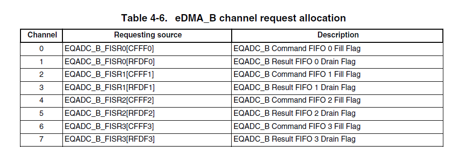

Command send from Cqueue_B_1 to CFIFO 1:-
void eqadc_B_sendcommand(void)
// initialize TCDs
eDMA_TCD_eQADCB_CFIFO_init(2, &CQueue_B_1, (void *)&EQADC_B.CFPR[1], sizeof(CQueue_B_1)/4);
eDMA_TCD_eQADCB_RFIFO_init(3,(void *)&EQADC_B.RFPR[1], &RQueue_B_1, sizeof(RQueue_B_1)/2);
eDMA_TCD_eQADCB_RFIFO_init(5,(void *)&EQADC_B.RFPR[2], &RQueue_B_2, sizeof(RQueue_B_2)/2);
void eDMA_TCD_eQADCB_CFIFO_init(vuint8_t DMA_chan, void *cmd_source, void *cmd_dest, vuint32_t cmd_count):- declaration of function
here 2,3 and 5 are DMA channel number according to this snap

davidtosenovjan
This is too little information. Please provide all eQADC and eDMA setup. Actually which device you are using?
Have you checked example code for eQADC I have shared here?:
https://community.nxp.com/docs/DOC-329623
