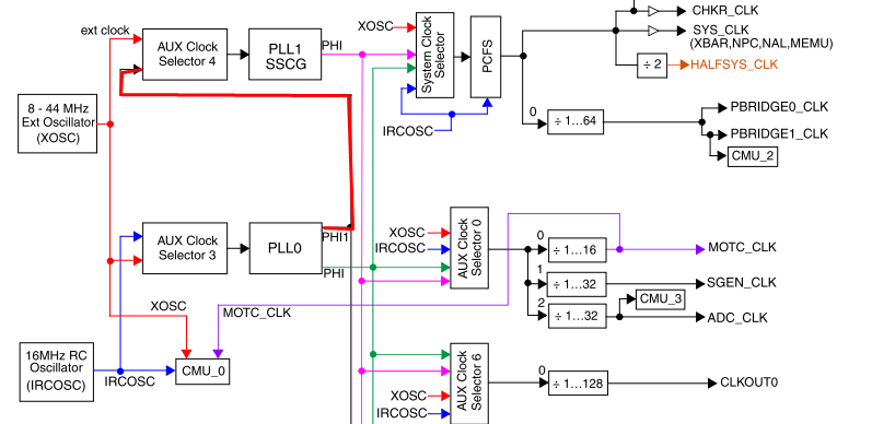

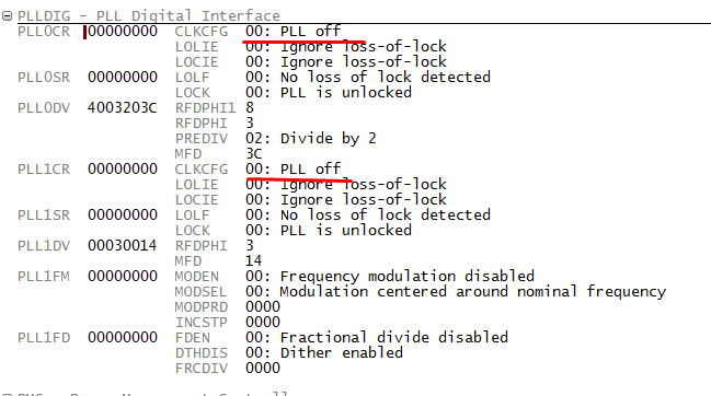

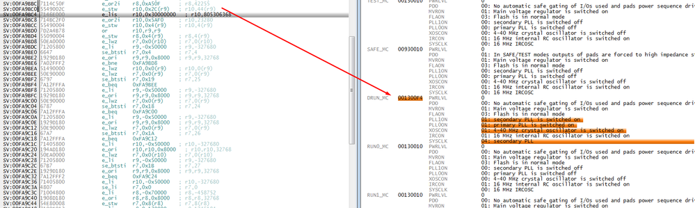

I've done debugging on your assembly code and I can see issue with mode transition at first:
see following pictures:
1. you have your PLL's off
2. You are connecting PLL0 PHI1 to AUX4 input for PLL1 generation:
3. But you have no PLL0 signal in this time.
4. The DRUN is your target mode and you are enabling both PLL's. PLL0 as source of PLL1 while you have no PLL0.
Your mode transition will fail and your system clock will stay IRC 16MHz. (I guess this is what you measure on output pin).
Solution:
1. Configure PLL0 , do mode transition. (PLL1 disabled in ME_MC_DRUN)
2. Enable PLL1 in DRUN mode and do mode transition again
This is also described in Reference manual.
You can also use our PLL calculator :Excel MPC5744P Clock Configurator
which generates code depending on Clock configuration.
Peter

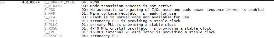

petervlna

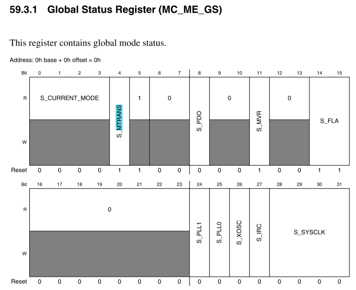

What do you see in MTRANS after your application mode change?
Did your micro takes mode change successfully?
Can you see on CLKOUT correct system clock.
Peter
5,095 Views
sagardhavali
It is 00 in both cases. Following is the register structure.
5,095 Views

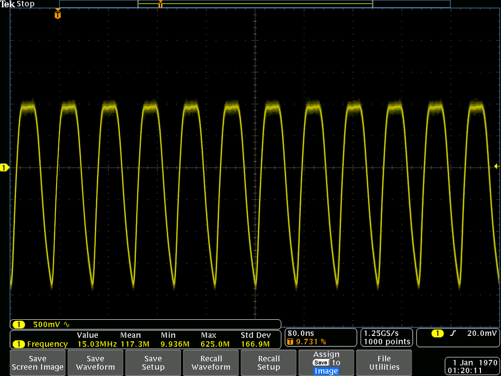

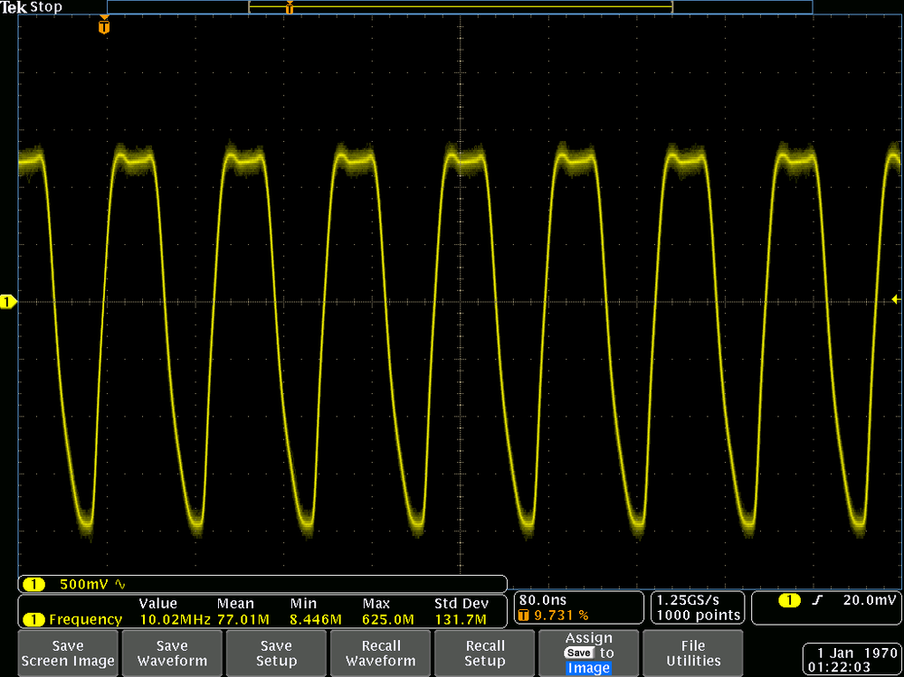

Here is what I measured CLK_OUT from both scenarios.
1. CLK_OUT when just application is run. You can see that frequency is 10MHz. With MFD = 20, SYSCLK=200MHz.
2. CLK_OUT when bootloader and application is run. See that the frequency is 15MHz. I don't know what is MFD here and hence do not know that is SYSCLK. As per our supplier's statement, they say they have the same configuration as we do. So, something is not right. MFD cannot be 20 because 20*15MHz=300MHz, SYSCLK is not possible for this micro.
Please let me know if I have misunderstood anything wrong.
5,095 Views

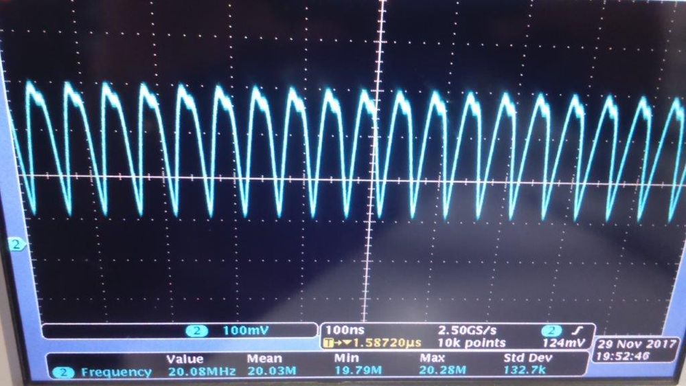

Here is an update:
When bootloader is ran, CLK_OUT is as follows:
(MFD=10. So, 20MHz * 10 = 200MHz)
When Application is ran, CLK_OUT is as follows:
(MFD=20. So 10MHz * 20 = 200MHz)
When both bootloader and application is ran, CLK_OUT is as follows:
It looks like MFD is getting averaged. I don't know what exactly is happening.
Can someone help me please?
5,095 Views
petervlna
Ok,
When you measure 15Mhz (bootloader and application run) check the configuration of CGM (clock generation module) and check also settings of PLL.
Or send me your output file and i will check it. (the failing scenario)
Frequency always corresponds to clock configuration. (if you measure it directly on CLKOUT pin)
Peter

sagardhavali
Thanks for replying.
Sure, I am attaching all output files. Also, following are the details.
Bootloader:
Output file name: Bootloader.S19
PLLDIG_PLL0DV=0x4003203C;
PLLDIG_PLL1DV=0x00030014;
CLK_OUT = 20 MHz
Application:
Output file name: Application.S19
PLLDIG.PLL0DV.R = 0x40021014;
PLLDIG.PLL1DV.R = 0x00020014;
CLK_OUT = 10 MHz
Bootloader + Application:
Output file name: BootApplication.S19
CLK_OUT = 15 MHz.
** This is the failing scenario **
Thanks for the help.
