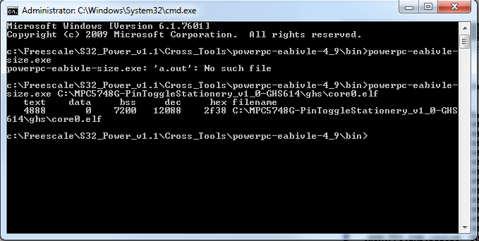

Tool powerpc-eabivle-size.exe you will find in S32 Design Studio installation folder, Cross_Tools/powepc-eabivle-4_9/bin.

Hi Pranav,
if does not matter if you use Code Warrior compiler or Green Hills compiler. This tool is able to tell you how much RAM and ROM is used. I am attaching the tool (you do not have to download and install S32 Design Studio or Code Warrior)

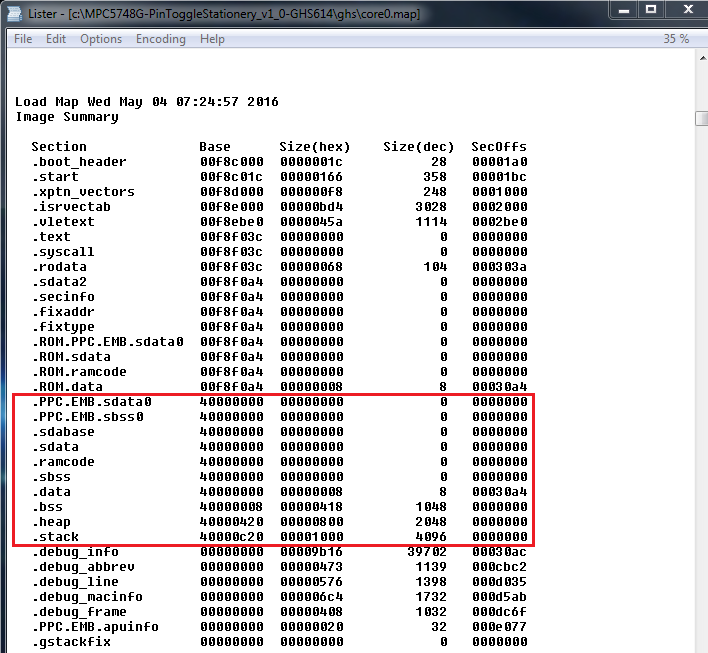

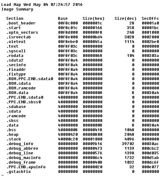

Information about memory usage should be also read from MAP file generated by linker. Please look at the figure below, which shows a part of MAP file generated by Green Hills.
Martin

I do have one question though: As I read in this thread View memory usage in CW 10.6 , you have mentioned that "value in column bss determines amount of data in RAM."
My question : Does RAM only consists of bss section and no other section contribute towards RAM ?
                       Where can I get detailed information on this ?
Pranav
4,464 Views
martin_kovar
Hi Pranav,

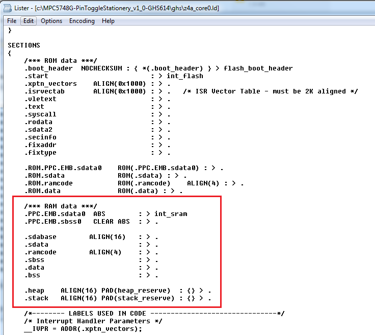

I have to fix my answer a little bit. Columns data and bss determines amount data in RAM. Section, which are placed in RAM are determined by linker file.
Please look at the following linker file and relevant map file are shown below.
If you add all these sections sizes, you will get the amount data in RAM.
Martin
