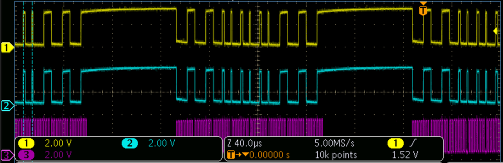

lukaszadrapa
I did quick test on EVB and it works as expected, I can see nice signals on my scope. My test code is attached (copied from other projects, maybe some comments are not valid).
If you use EVB, PA6 and PA7 are available on J13 on the adapter:
Lukas

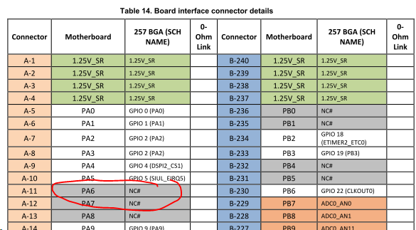

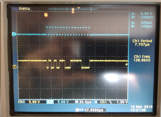

nxf49919
Hi Lukas
Thank you very much, your test is right.
When I test again, I also observed the output signal in PA[6] and PA[7] by J13.
I already know the reason.
Only PA[8] PA[7] PA[6] in the MPC57XXXMB Evaluation Board Motherboard which I use to test did not connet to S32R274 corresponding pad.
So I only can observe the PA[6] PA[7] PA[8] output signal in Daughterboard J13.
We can output SPI_1 signal in PA7[channel1], PA9[channel2], PA6[channel3] signal as follow:

lukaszadrapa
Hi Huaqiang,
it's mentioned in the user guide, section 5. Board interface connector:
https://www.nxp.com/docs/en/user-guide/S32R274-EVBUG.pdf
Lukas
