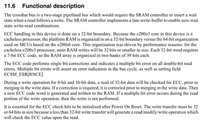

Here you can find the reason why it is necessary to initialize the SRAM:
It's necessary to initialize SRAM in startup files before you read or write the SRAM. Easiest way: search for MPC55xx_init_debug.c file and change
#define INIT_DERIVATIVE_INTERNAL_SETUP 0
to
#define INIT_DERIVATIVE_INTERNAL_SETUP 1
Then function INIT_Derivative will be called in startup files.
It is necessary to change the base address and size. In the original code, base address is 0x4000_0000. You need to change it to end of your RAM image. Align the address to 128 bytes. And then change also the size.
stmw instruction is used for initialization - it writes all 32 general purpose core registers to SRAM.
When reading the description, I guess that it's really caused by the ECC.

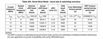

And also be aware that core watchdog is enabled:
It's necessary to refresh it or disable it.

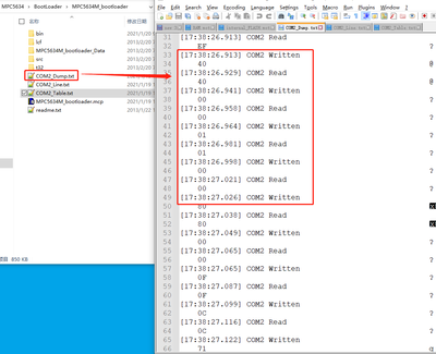

2. Yes, I check each echo byte in the host computer, and continue to send the next byte after confirming the consistency.
3. RAM.mot is not continuous, but I set it to be filled with 0xff in the sending program of upper computer.

"Notice that downloading of code also initializes ECC. Area that is not written by BAM will contain ECC errors. If your application wants to use uninitialized RAM, it must be explicitly initialized by your SW. "
In the linker file, stack is usually placed at the end of RAM memory. Do you load the image up to end of RAM / stack? If not, the RAM is not initialized. Second option is to initialize the rest of RAM by your startup files. This option is better, it's much faster than loading via BAM. See INIT_Derivative function. This can be used. It's not called in case of RAM project but you can reuse the code.
