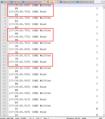

Hello everyone, the microcontroller I use is mpc5634m. Now I want to write the test program to RAM by using esci in BAM mode. The test program sends out a few characters, but the program is not executed in RAM. As a test comparison, I use OSBDM to brush the RAM program to the microcontroller. The program can be executed. I don't know why. Can someone help me? The following is the source program, and I use my own upper computer program to write RAM.mot data of the whole process.
I follow this step, modify the start address, and use 0xff to fill the discontinuous memory address in the upper computer program, but the result is still unsuccessful.

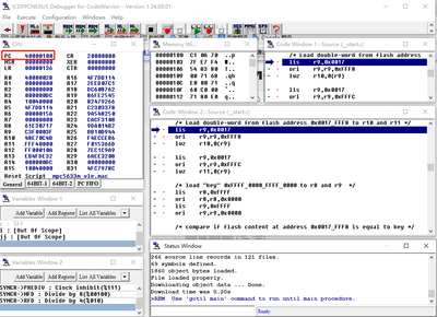

1.  I set the address to 0x40000100.
RAM.map is shown in the table below:
When using OSBDM to debug ram target, the program counter (PC) points to:
When the host computer sends, the address is the same:

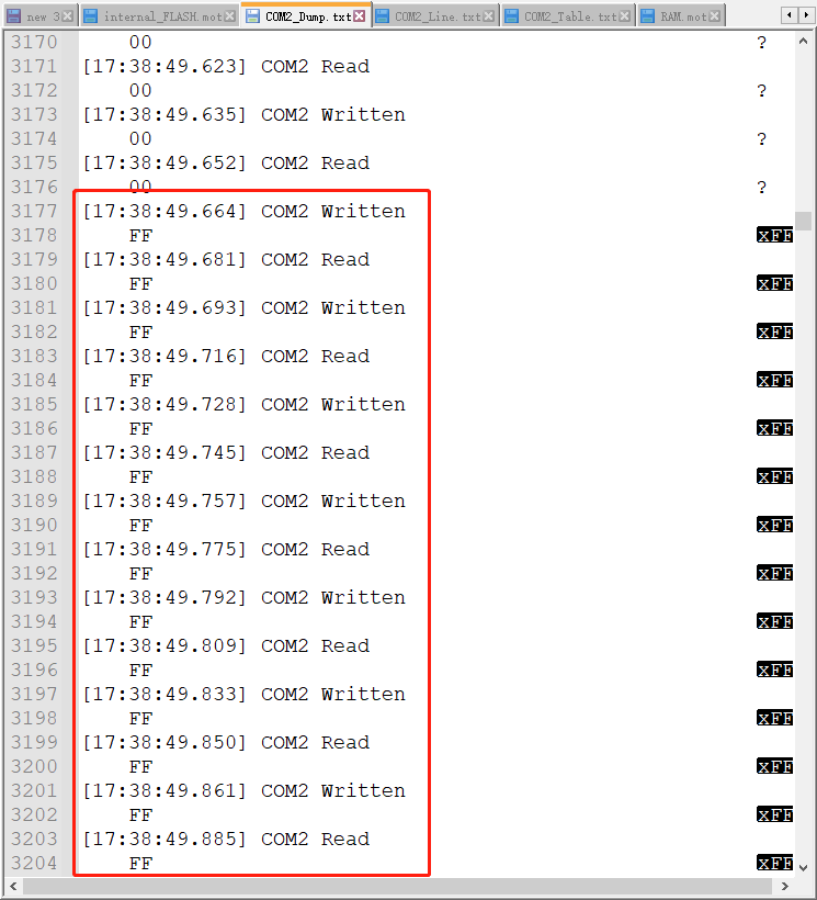

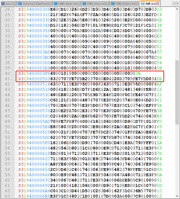

2. Yes, I check each echo byte in the host computer, and continue to send the next byte after confirming the consistency.
3. RAM.mot is not continuous, but I set it to be filled with 0xff in the sending program of upper computer.

"Notice that downloading of code also initializes ECC. Area that is not written by BAM will contain ECC errors. If your application wants to use uninitialized RAM, it must be explicitly initialized by your SW. "
In the linker file, stack is usually placed at the end of RAM memory. Do you load the image up to end of RAM / stack? If not, the RAM is not initialized. Second option is to initialize the rest of RAM by your startup files. This option is better, it's much faster than loading via BAM. See INIT_Derivative function. This can be used. It's not called in case of RAM project but you can reuse the code.
