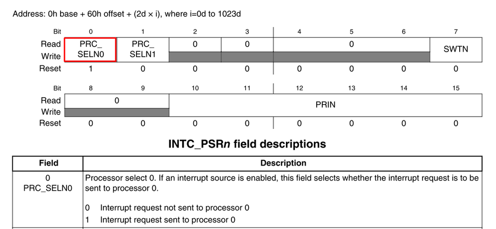

In the Reference Manual for MPC574x Power PC, interrupts section, there is frequent reference to Processor Master ID as in this description for the PSRn register configuration:
Only the processor with master ID zero will be allowed to write the INTC_PSRn[PRC_SEL,SWT]. When writing the INTC_PSR[PRI], only the processor with master ID 0 and the processor who’s master ID matches the setting of the
INTC_PSRn[PRC_SEL] will be allowed to write the INTC_PSRn[PRI]. An attempt by any other processor to write the PSRn[PRIn] will result in a termination error.
If INTC_MPROT[MPROT]=0 (disabled), all processors have write access.
If INTC_MPROT[MPROT]=1 (enabled), the processor with master ID (0-3) = INTC_MPROT[ID] or the corresponding processor has write access to INTC_PSRn[PRC_SEL,SWT], otherwise, a termination error is asserted. When writing
the INTC_PSRn[PRI], only the processor with master ID (0-3) = INTC_MPROT[ID] and the processor whose master ID (0-3) matches the setting of the INTC_PSRn[PRC_SEL] will be allowed to write the INTC_PSRn[PRI]. An attempt by any other processor to write the INTC_PSRn[PRI] will result in a termination error.
For all other configuration, I use the coreId of 0 to n-1 (n = number of cores) to split the processing between the cores. (a) What is master ID? is it different from coreId?  Is it configurable by the user?
(b ) what does "corresponding processor" mean in the above description?
(c) In S32DS, how can I configure MPROT and MPROT_ID using Processor Expert?
(d) For my application, i want to use Software interrupt SS5_IRQn to interrupt core1 from core0. Only core0 should be able to set the interrupt and only core 1 should be able to clear the interrupt. How should the register be configured?
Thank you.
Master ID => is the logical bus master assignments
As I do not know which device you are using I can only show below the screenshot of MPC5746R reference manual.
Means only processor which ID corresponds to INTC_MPROT access settings.
I am not familiar with PExpert. Someone else should answer you quesiton.
1) Program INTC_PSR5 for core0 interrupt execution only.
This is done by default from reset settings
2) Program INTC Master Protection Register (INTC_MPROT) according to your needspastedImage_23.png
