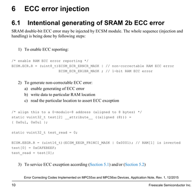

I am trying to generate ECC error using EEGR registers.
When I try to simulate a Non-Correctable error using FRCNCI register, the controller resets.
Is there any documentation to refer and understand this behavior ?

Please refer to AN5200:
https://community.nxp.com/t5/MPC5xxx-Knowledge-Base/AN5200-Error-Correcting-Codes-Implemented-on-MPC...
Chapter 6:

Is there any reason why the controller would reset after setting the non-correctable error generation bit ?
Aditya
2,223件の閲覧回数
petervlna
it depends on how you handle exception. If it is unhandled they you will get reset. If the reset is triggered in exception, you will get reset. etc...
refer to : 5.1 Based on IVORx exception
