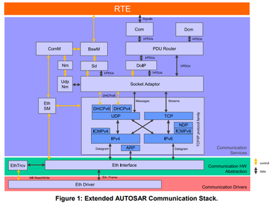

If you don't want to use RTOS, then Bare-metal embedded system approach is a choice.
Setup your Stack inside a task within a super loop :

It depends on how you implemented in that super loop. NXP package for MPC only focus on Autosar MCAL layer, while TCP/IP stack is placed between Socket Adaptor and EthIf layer.
