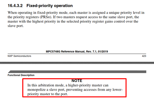

davidtosenovjan
Hi, in this test case i would say, possible cause be XBAR priority setting
I would try to use round-robin configuration for both cores. Let me know if it helps or not
6,648件の閲覧回数
1045302770
Hi, thanks for your reply.
I have tried to use round-robin configuration, but it doesn't work, the exception still happens. My original XBAR configuration is as followse:
6,661件の閲覧回数
1045302770
@lukaszadrapa  @davidtosenovjan Sorry for bothering you, but would you please give me some advice to solve this problem?
