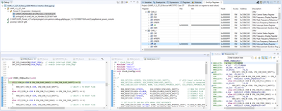

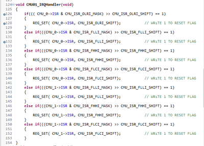

I am working on CMU. I enabled all the CMUs and their interrupts. the first problem occurs when a CMU01 interrupt event is generated. then program goes into all "if, else if" conditions. as shown in the figure there are three break point. the program stops on lines respectively 126, 128, 132, 126, 128, 132...when the program stops at line 126, I look to CMU0 and CMU1 ISR registers from embedded register section. I see that there no interrupt request from CMU0 but the program still goes into CMU0's conditions. There is no error in my "if, else if" conditions as you can see. let say my condition is wrong so program goes into first "if" condition. how can it goes in to "else if" conditionwithout reentering to the CMU01_IRQHANDLER? I wrote the sequence of the flow of program above. The program goes into else if without reentering to the CMU01_IRQHANDLER.

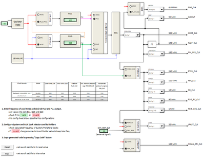

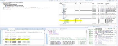

second problem is again about CMU01 interrupt. I set the clock frequency to max frequency of system. which is 300MHz PLL1 output and 240MHz PLL0 output. CMU1 was adjusted for checking signal according to 300MHz clock signal. I set the LREF value as 30Mhz for dont get any interrupt request from CMU1 FLL. but the program still set interrupt flag of FLLI. you can see screen shot above for this issue. clock configuration is placed under this text. my question is that how can I fix this issues? did I do something wrong? Can you give information to me about that?
