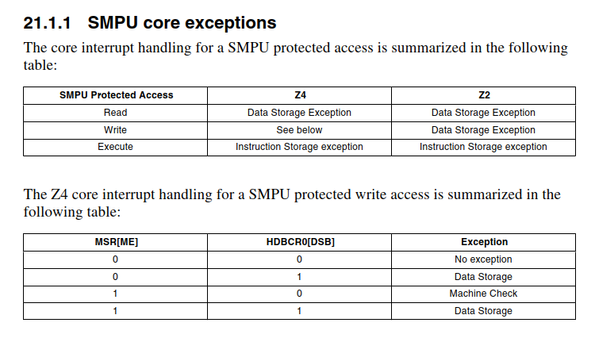

It should not be any difference between disabled cache and access to the SMPU region with cache inhibited attribute. Please check SMPU setting. Btw it is stated that aborted core accesses generate instruction storage (ISI) or data storage (DSI) interrupts, what would fit to described behavior.

I mean that access can be terminated (aborted) by SMPU. You could investigate SMPU status registers at the time of error.

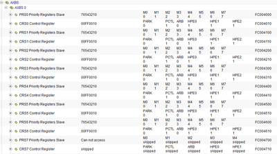

Hi, in this test case i would say, possible cause be XBAR priority setting
I would try to use round-robin configuration for both cores. Let me know if it helps or not
6,824 Views
1045302770
Hi, thanks for your reply.
I have tried to use round-robin configuration, but it doesn't work, the exception still happens. My original XBAR configuration is as followse:
6,837 Views
1045302770
@lukaszadrapa  @davidtosenovjan Sorry for bothering you, but would you please give me some advice to solve this problem?
