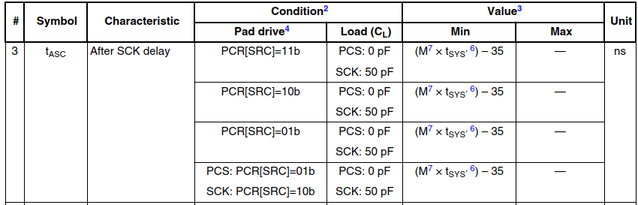

Such configuration is not possible. There is always certain minimum time between tASC/tCSC (as stated in the device datasheet), excluding mode with Continuous SCK.
You said "SLAVE doesn't require Continuous SCK" what does not imply such configuration cannot work. There is also CS signal that is being asserted only during transfer.

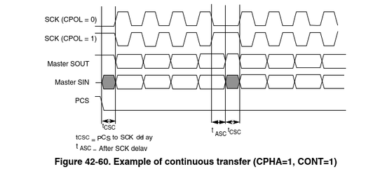

I think it is configuration like this:
Isn't it?
Can you zoom SCK signal below marked delays.
Actually what is the meaning of the question? Do you see some behavior contrary to the documentation description?

As shown  "Figure 42-62. Continuous SCK timing diagram (CONT=1)"    in RM, our requirement also  same, except continuous SCK (SLAVE doesn't require Continuous SCK). SCK should be there only during transfers. Suggest us the possible configuration.

Same couldn't  match MPC5777C to SLAVE, because of tCSC and tASC .
