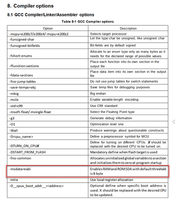

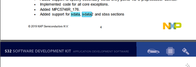

My bad! I am referring to the Small Data Areas. While I could make them work in the GHS environment, I cannot understand how gcc handles them... it was creating .sdata and .sbss sections and allocating things there by default, but it did not look like it was doing accesses indexed by r13.
1,740 Views
davidtosenovjan
Maybe you need to enable it as follows:
https://www.nxp.com.cn/docs/en/release-note/S32SDK_Power_Architecture-RN.pdf
Regarding interrupts:
Interrupts request is triggered in the same cycle for both cores. ISR Handling is however application specific.
