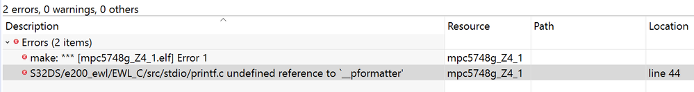

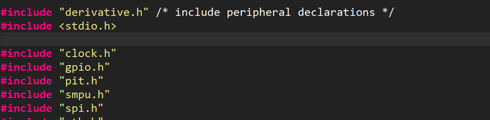

Recently, I try to use the function "printf()" in the MPC5748G project in S32 DS, but it always became error: printf.c undefined reference to '_pformatter' , as the figures below shown:
and I already added "stdio.h" .
Is there any configurations that I made wrong ?
Please help me to deal with this problem.
Thank you!

martin_kovar
add this option to the linker flags:
-Xlinker --undefined=__pformatterFP -Xlinker --defsym=__pformatter=__pformatterFP
Now it will work.
Martin
9,619件の閲覧回数
huqiang
Thank you very much!
But after I added the linker flags, it still have a error and this error even have no explanation
If I do not use the function "printf()", this error will disappear.
It seems that I still need to change something?
