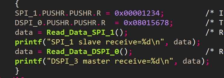

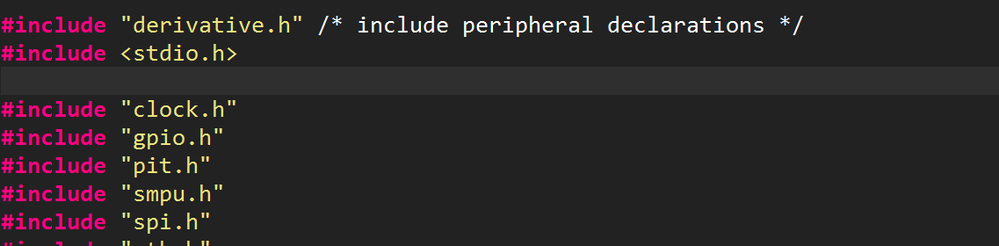

Recently, I try to use the function "printf()" in the MPC5748G project in S32 DS, but it always became error: printf.c undefined reference to '_pformatter' , as the figures below shown:
and I already added "stdio.h" .
Is there any configurations that I made wrong ?
Please help me to deal with this problem.

martin_kovar
add this option to the linker flags:
-Xlinker --undefined=__pformatterFP -Xlinker --defsym=__pformatter=__pformatterFP
Now it will work.
Martin
