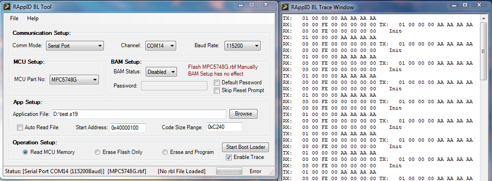

I tried RAppiD Boot loader on my MPC5748G DEVKIT. But failed to communicate with it.
First I flashed the MPC5748G.rbf using S32 DS via OpenSDA. Then using the RAppID BL Tool, I tried to read MCU memory. But trace window shows that it is not getting response from RBF.
Do I need to do some thing else to get it working?
Sandeep

lukaszadrapa
I was told that there's some problem in virtual serial port (OpenSDA firmware) on DEVKIT which is still not resolved. I tested it on DEVKIT and it really doesn't work. It looks like the virtual serial port adds some characters to communication, so it leads to communication error between RBF running on MCU and Rappid bootloader application running on PC.
I'm able to make it working on this EVB board:
Evaluation System for MPC574xB/C/G Family|NXP
So, the bootloader works but not on the DEVKIT...
Lukas

lukaszadrapa
Hi Hugh,
as mentioned above, there's no problem with Rappid bootloader, there's problem with OpenSDA. It's not open source.

lukaszadrapa
Hi Sandeep,
I do not know the problem in OpenSDA in detail. As far as I know, it adds some unwanted characters to communication. I can try to find out more details next week (engineers who knows more is out of office now).
That means it will affect any serial communication which uses virtual serial port on OpenSDA. If the behavior is predictable, it could be possible to use AN5319. I will tell you more at beginning of the next week.
Lukas
