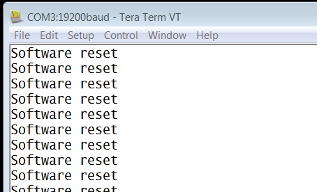

davidtosenovjan
That's interesting. I have just test it and works fine on my side:
It is being periodically reset by SIU.SRCR.B.SSR = 1; running standalone without debugger and with debugger as well.
Used MCU is SPC5777CCMMO3 3N45H. I have checked various errata lists and I havent found anything what would be similar to your description.
Would you check attached code?
