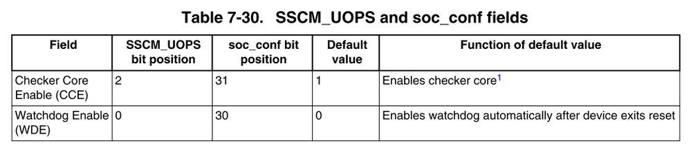

HI,
How to disable checker core of MPC5744P with S32DS?
3,101 Views
stanish
I assume you are using PEMICRO debug probe.
please have a look here:
https://community.nxp.com/docs/DOC-334094
Hope it helps.
Stan
3,101 Views
3ali
Yes I use PEMICRO debug probe and the doc you posted is very helpful.
Ahank you very mutch.
Ali
3,101 Views
petervlna
You have to write SOC configuration record DCF record.
You don't have to use any special DCF record strategies:
Your DCF record will be:
0x0100_0024_0000_0000
Program it to fist free address in UTEST memory DCF user area.
Peter
