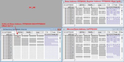

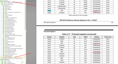

Some modules, such as MC_ME, can set the Register Protection, as shown in the fig.1, but some other modules, such as CMU_0, can't use this function, and it's soft lock bit not exist, as shown in the fig.2.

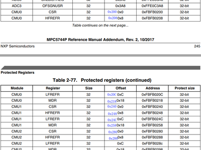

Another question, in the Protected Registers list, why different modules have same Base Address? as shown in the fig.3, CMU0 and CMU1 has a same Base Address 0xFBFB0200, is it correct?

The note is correct.
The base address for all CMUs is 0xFBFB_0000.

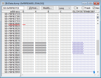

f the Base Address is 0xFBFB0000, the SoftLock bit should be 0xFBFB0000+0x3800=0xFBFB3800, but this address is still not accseeable as is shown in fig below. So could you tell me how to calculate the CMUs' Mirror Address, SoftLock Address and HardLock Address?
You calculation is not correct.
You have to take base address of the register: which for 0xFBFB_0200 which is only valid for CMU modules, for other peripherals your base is base address of module.
So for soft locking of CMU0_ CSR register you will do write to 0xFBFB_2200.
And lock register you will see at address 0xFBFB_3880 for CMU0_CSR.

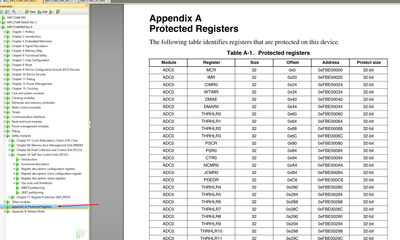

Only registers listed in appendix A can be locked by register protection:
So not all registers in module support this feature. Usually its only safety relevant.
Well, that is copy paste typo in manual, please have a look at manual Addendum instead:
Here are the addresses:
#define CMU_0 (*(volatile struct CMU_tag *) 0xFBFB0200UL)
#define CMU_1 (*(volatile struct CMU_tag *) 0xFBFB0240UL)
#define CMU_2 (*(volatile struct CMU_tag *) 0xFBFB0280UL)
#define CMU_3 (*(volatile struct CMU_tag *) 0xFBFB02C0UL)
#define CMU_4 (*(volatile struct CMU_tag *) 0xFBFB0300UL)
Peter

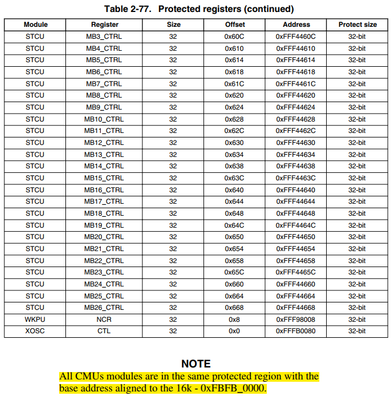

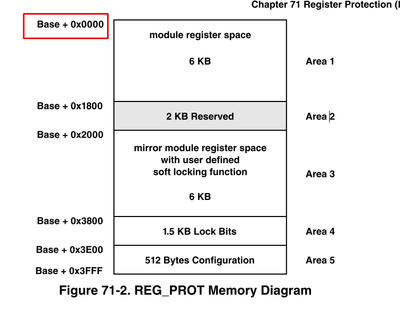

I think I find the answer, but I don't understand. Thanks for your screenshot I saw the NOTE and it said " All CMUs modules are in the same protected region with the base address aligned to the 16k - 0xFBFB_0000", what's the meaning of this?
If the Base Address is 0xFBFB0000, the SoftLock bit should be 0xFBFB0000+0x3800=0xFBFB3800, but this address is still not accseeable as is shown in fig below. So could you tell me how to calculate the CMUs' Mirror Address, SoftLock Address and HardLock Address?
It's so funny different with other modules.
Jamber
14,138件の閲覧回数
petervlna

I think it's better understand if modified the value of "Offset" of CMU in Table2-77 to 0x200, 0x208, 0x20C, et.al. but now I get it anyway, thank you.

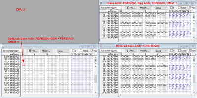

"Only registers listed in appendix A can be locked by register protection:", what confused me is the CMU0 module is right in the Appendix A, but I can't access its SoftLock bit, and I post the screenshot in my question.
