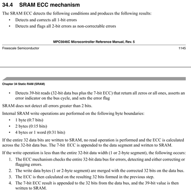

I am trying to read the internal RAM using the BAM module, via the UART
The problem is that there is a repeating pattern in the received file, that doesn't look correct.
This is the code i am using.
#define RAM_BASE    0x40000000
#define RAM_SIZE    256*1024

Is this supposed to be normal, or i am getting something wrong. Its a new processor, an empty one, isn't it supposed to be empty.
1,346件の閲覧回数
lukaszadrapa
Hi @BorisB
RAM memory contains random data after power on. It must be initialized:
 It's done in startup code like this:
stmw instruction is used - it writes all GPR core registers to RAM in a loop. That's the reason why you can see such pattern in the RAM.
