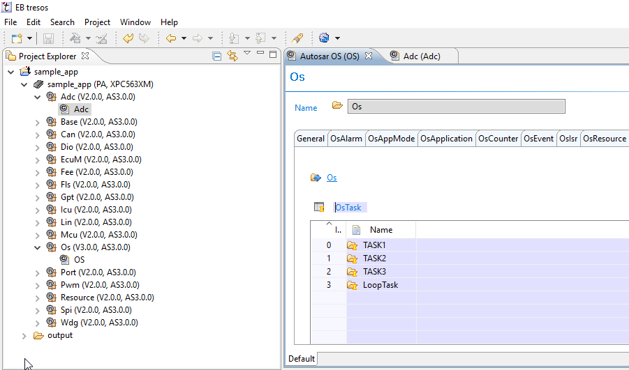

Hello All,
I am trying to run AUTOSAR on MPC5634M with NXP MCAL&OS  with EB Tresos studio.
For this chip, NXP supports AUTOSAR v 3.0.
I have two questions:
1) I am using "Tresos Studio " Release ver 2009.a build number: b090820-1820.
OS Ver: Freescale AUTOSAR OS/MPC56xxAM v.3.0 RTM, build 3.0.35.
I have also added the patch "OSMPC56xxAM_3_0_35_patch1"
I receive the following error (attached image) after importing the sample project: "os_sample_sc1" located in "\AUTOSAR\os_freescale_mpc56xxAM\os_ts\eclipse\workspace" to Tresos studio and running "Generate Project".
I am running on windows 7 64 bit system. Is a 32bit OS required for the configuration?
2)  The MCAL provided for the same chip is "AUTOSAR MPC563XM MCAL3.0 swv: 2.0.0 RTM". But this MCAL version expects "Tresos Studio ver 2010". But as stated in qn. 1), OS expects "Tresos Studio " Release ver 2009.
How  can i configure the entire project in this case, when there is a conflict in versions as seen here.
Any help to address the above questions and get the configurator to work is appreciated.
Your Sincerely,
Arjun

2) There can be used the newer version (Tresos 2010.sr4) to configure both MCAL and OS. See the MCAL sample application (located in c:\Freescale\AUTOSAR\MPC563XM_MCAL3.0_RTM_2.0.0_signed\MPC563XM_MCAL3.0_RTM_2.0.0_Integration_Application) where both MCAL and OS are integrated within one project. See here the screenshot from Tresos:

Hello Frantisek,
Thanks  a lot for the solution.
It has worked perfectly well and now I am able to generate code from Tresos studio.
Thanks  a lot for taking the time out to answer this query in detail.
