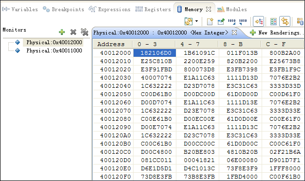

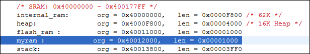

Thank you very much to give me this answer ,but i still can't erase the area 0x00100000 of bank0 , I have Relocate flash programming code to SRAM address 0x40012000,and updated the LCF flie like this:pastedImage_1.png
and when debug ,There is  the data in the  the SRAM address 0x40012000,you can see as follow:
but the result is not ok, I still can't erase or write the bank0 area 0x00100000,so I want to ask you :
1.Whether My LCF file config is correct? if not,what is the correct configration?
2.Whether need the other config in other files?if need.could you tell me how to config ?

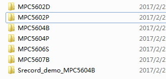

      thank you for your support ,and  I have another question about the SSD ,where can I find the MPC5634 flash driver and demo program?
the SSD :MPC56XX_C90LC_JDP_SSD_100_DEVD ,I am not sure it can use .it just support the following chips:
Do u have any suggestion ?
3,585 Views
davidtosenovjan
You can see any of these demos as the principle is the same. SSD library can be applied to MPC5634M device as well.
